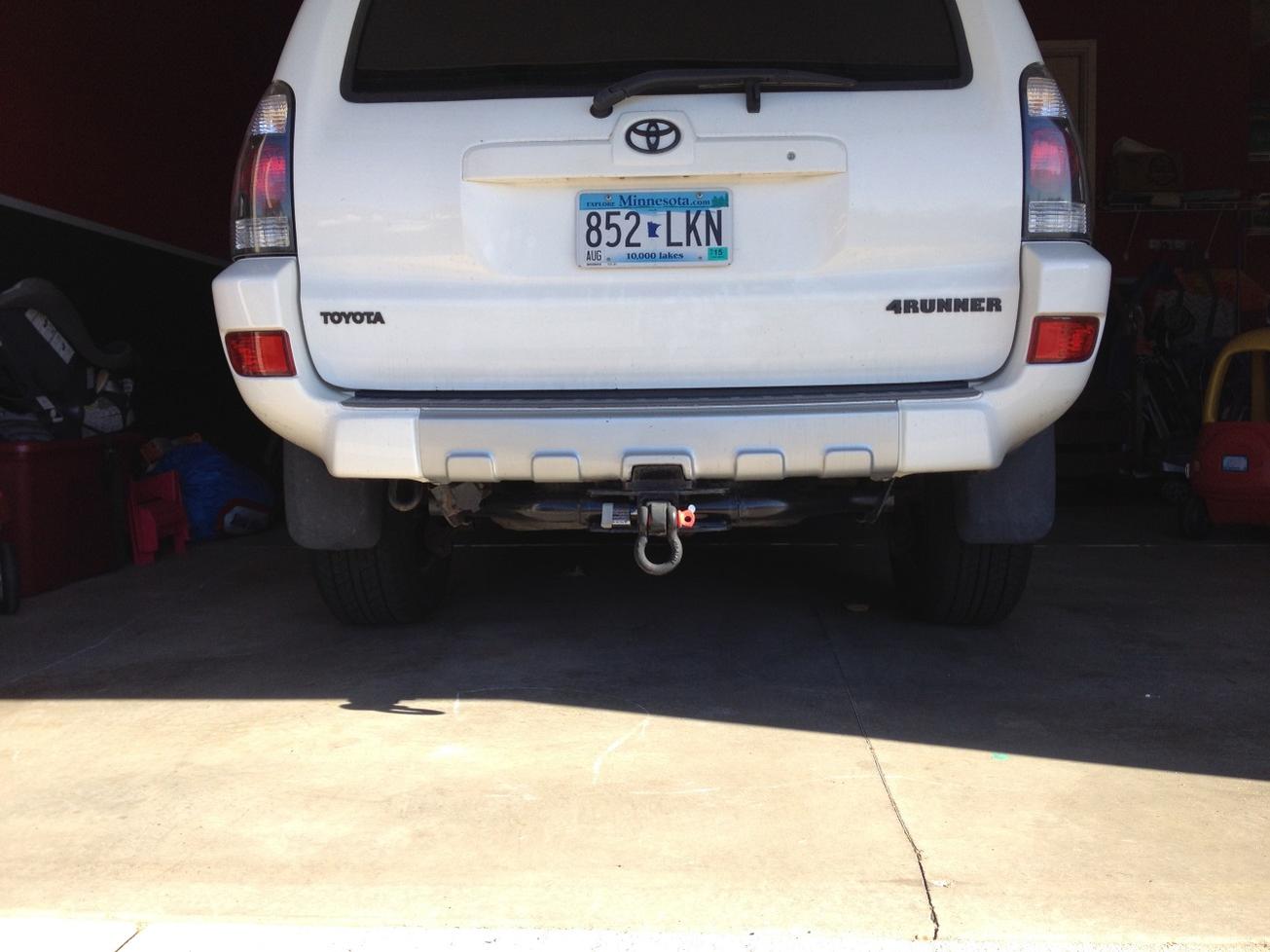

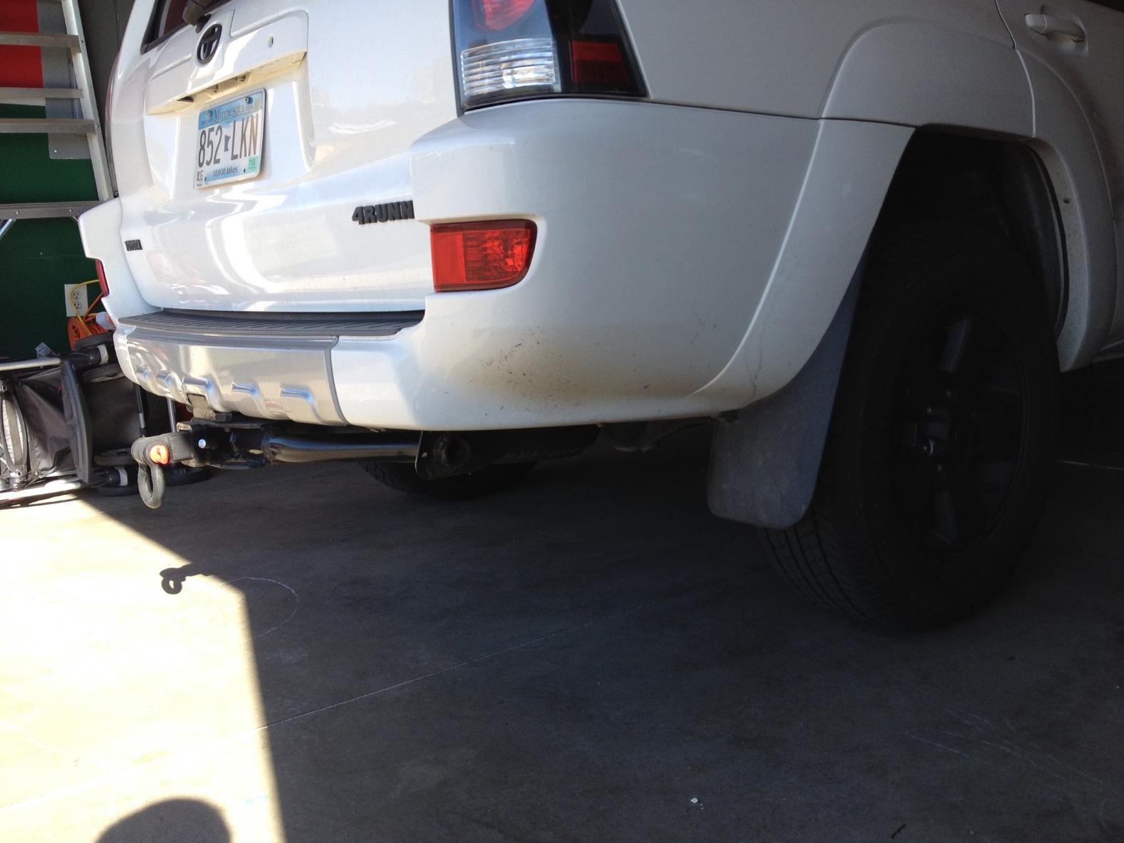

I went with the non-stainless Gibson exhaust. I purposely did not install the final 2 foot extension which runs out the back. In my opinion, a much cleaner look. The tip of the exhaust is still rear the differential, but is not visible.
The sound is a deep gurgle at idle, but not loud. There is an audible drone at cruise speeds, but it's not annoying. If anything it's a very complimentary sound to the look of the vehicle. A head or two will swing to see if it's really your 4runner.

Do you get any exhaust fumes inside the cabin? This would be my biggest concern...

I had this very concern originally. But after the install I can say that there is no exhaust fumes inside the cabin (either at idle or at speed). By sheer luck, the exhaust still flows rearward, but also downward at the same time. The tip is actually adjacent to the spare tire, so it's a bit further back than the pictures might suggest.
My wife and mother-in-law has been driving the car since I've been out of the country and they have not complained about the exhaust either.
