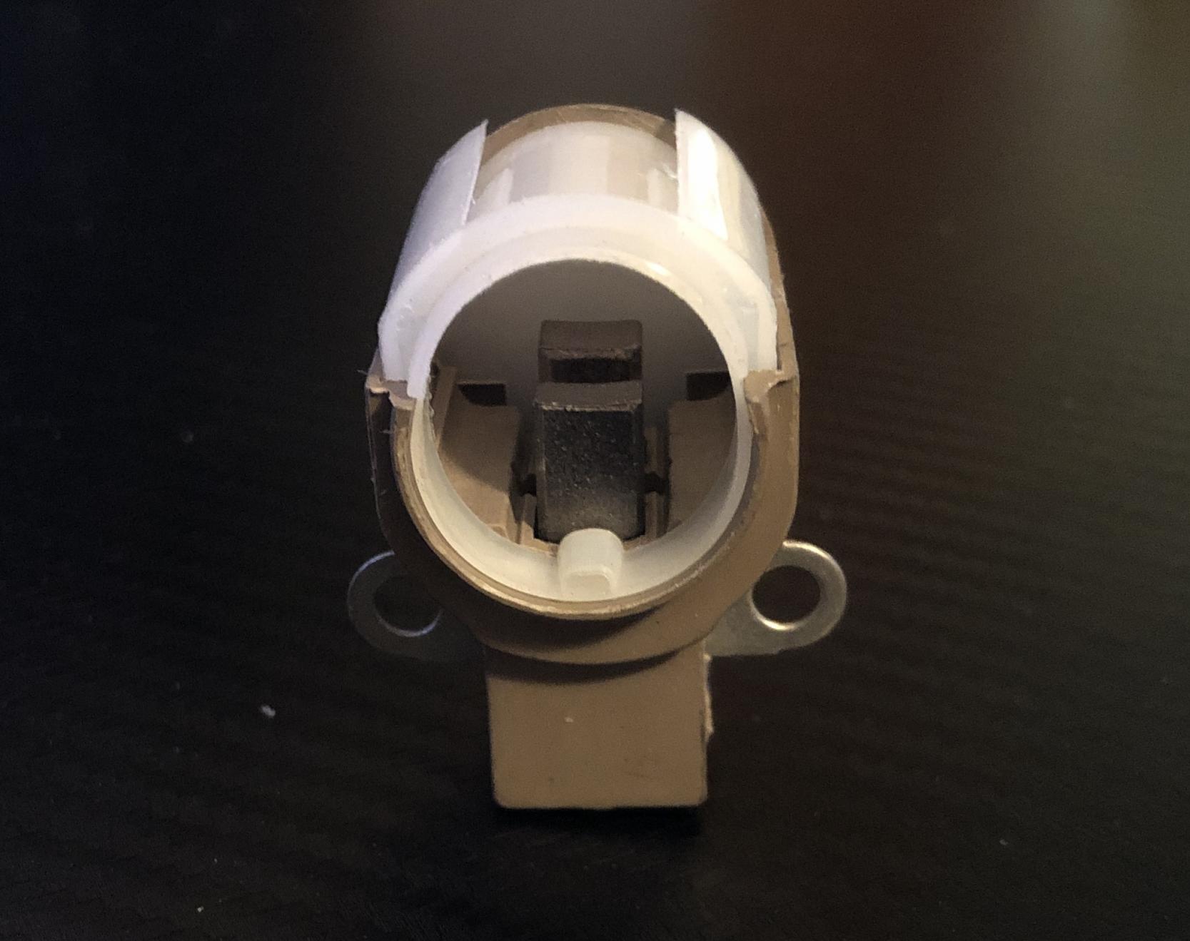

For your old one as backup, do yourself a favor and remove the brushes for inspection. They're probably almost completely gone, and replacing them takes 5 minutes once you have the alternator out, and $20.00 for the part.
