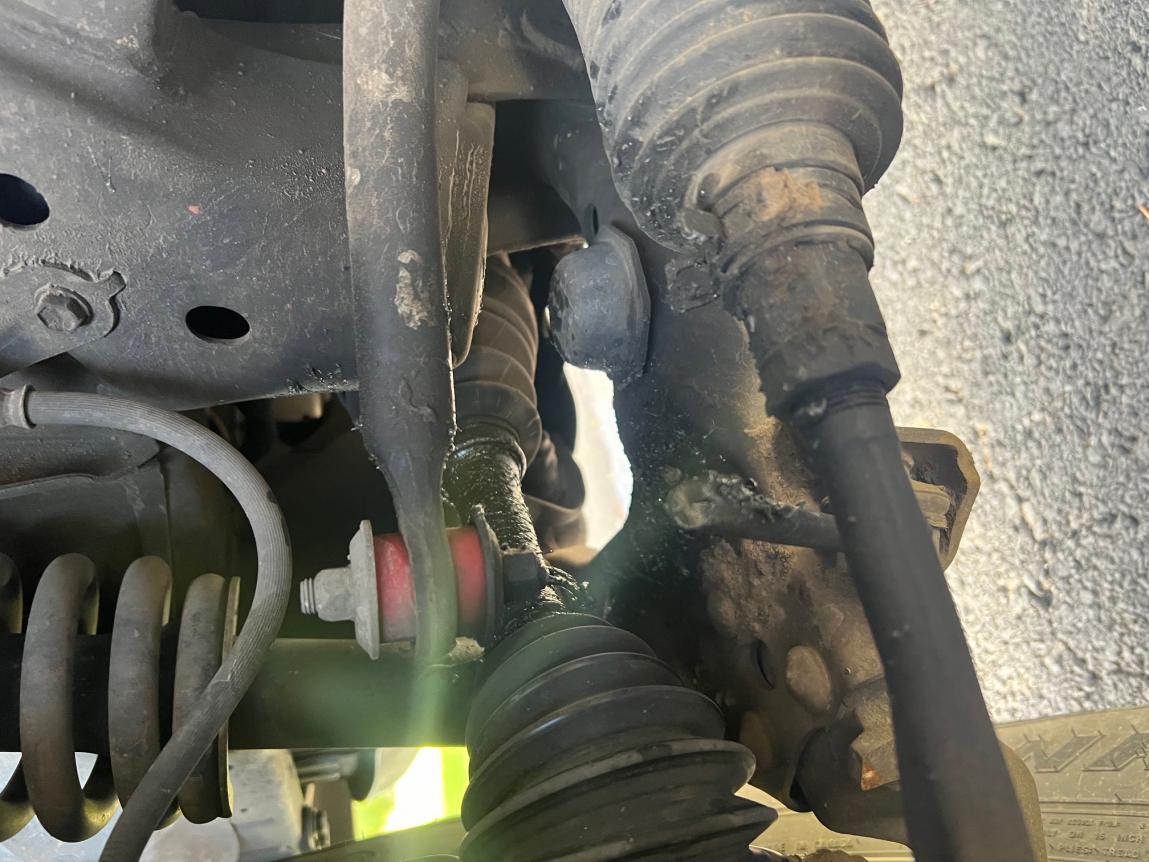

On a trip my sway bar end link snapped, it took off my cv boot clamp and made it fling out some grease. I can't find any tears in the cv boot, and I replaced the metal clamp.

I took a photo when it happened, so that should give you an idea.

Personally, I would remove both links, strap the sway bar out of the way and drive home.
A swap is pretty easy with the right tools, but I'd rather do it in my garage than a parking lot.

Those boots are packed with a lot of grease. If only a bit came out and you don't think there was an opportunity for dirt to get into the boot then I'd say clamp it and move on. You can reboot some other time and be fine.

I already replaced the broken link so that won't be a problem.
I finally get to share my dirty little secret. I drove around on an OEM axle with a ripped boot for over four years until I replaced it. I just trashed it afterwards, but not once did I ever encounter any problems as a result of it being torn open and flinging grease the way it was. Your mileage may vary, of course, so do what you will with the above information. I’m not saying it’s a great thing to do, but that’s just my own personal experience!
