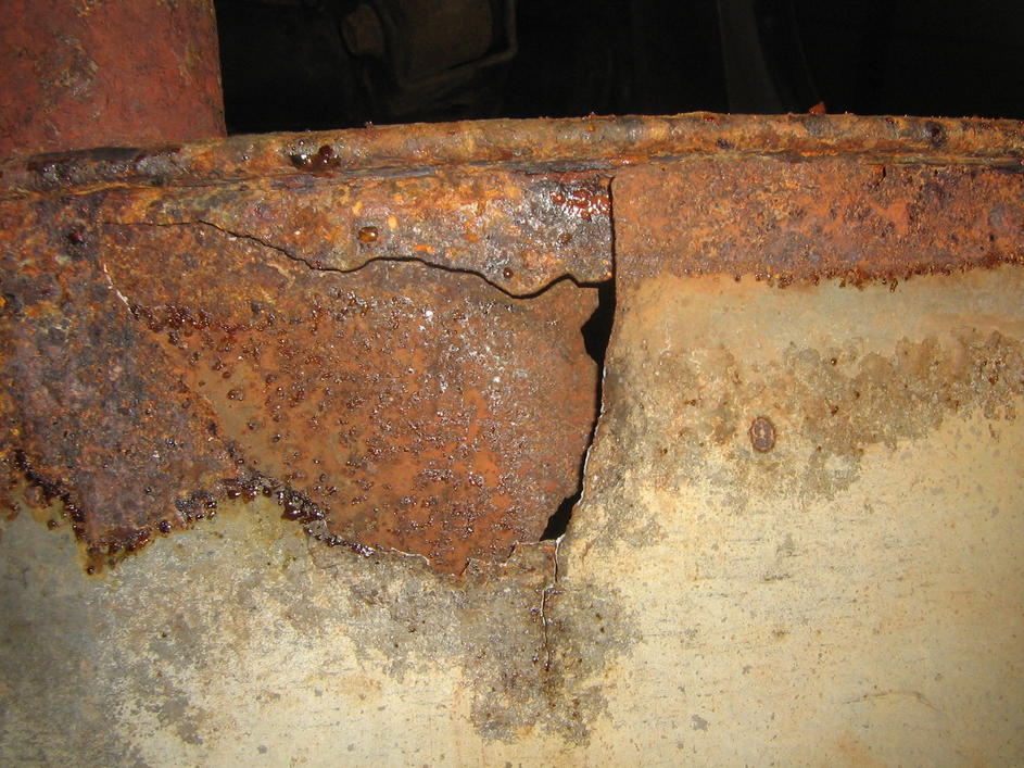

My cheep napa was bought in 2013. Still isn't rusting. It's got around 5000+ miles may be more. It was on the 96 till it got wrecked in September of that year. I put 4000 on it since I put the engine in.
This was my cheap Napa muffler, maybe a different manufacturer than yours. I drove 50 miles each way to work in rain & snow only. Took the car on nice days.
Was it just a muffler you scabed into the exhaust, or was it the aluminized complete muffler flange to flange? My setup is alumized. Both sections.

You're right, thanks for jogging my memory, my mechanic at the time just replaced the muffler. It left a bad taste in my mouth. I usually like Napa parts.
