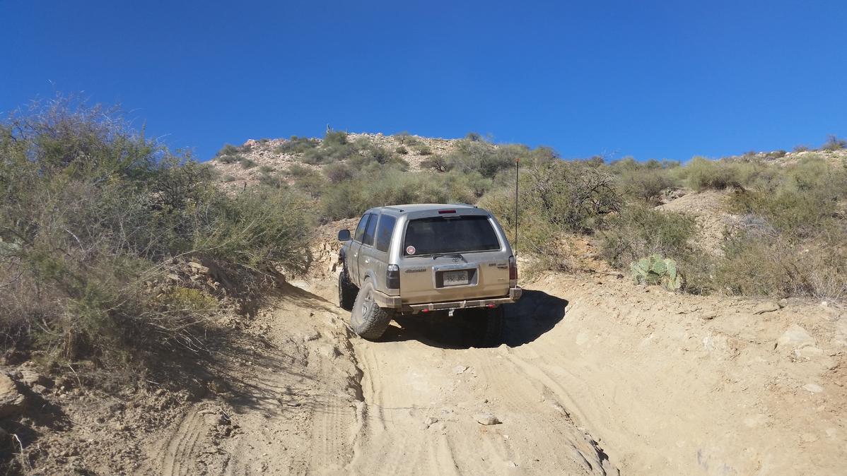

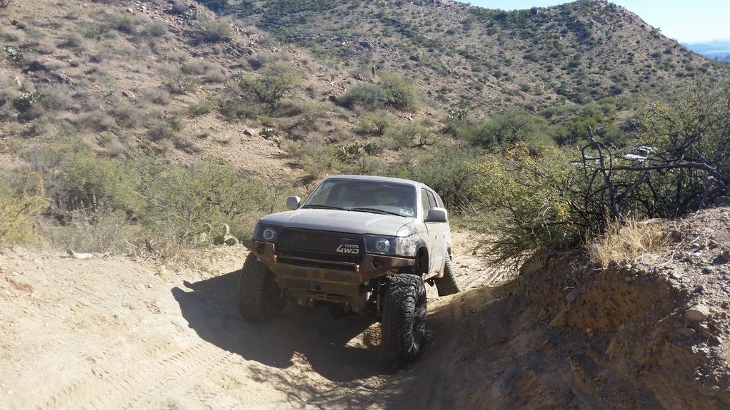

I run ome 881's up front and they flex just like any other spring all the way to the bump stop and droop just fine.
Just when I was about to take my shirt off and start flexing for the camera for this thread I realized that u were referring to suspension flex. Some will get a kick out of my avatar
D Farms, that is some pretty amazing front flex.

for reference, I have trimmed bump stops up front by over an inch, but i also have a progressive body lift thats 0" in the rear and 3" up front. the front is also tubbed to fit 35s with the extended up travel. no front sway bar. tundra 5100s with stock coils on the 4th perch. in the rear i have 8.5 wrap lc coils, monroe lc shocks, panhard lift, 2nd gen rear links on my sway bar, extended trailblazer bump stops.
