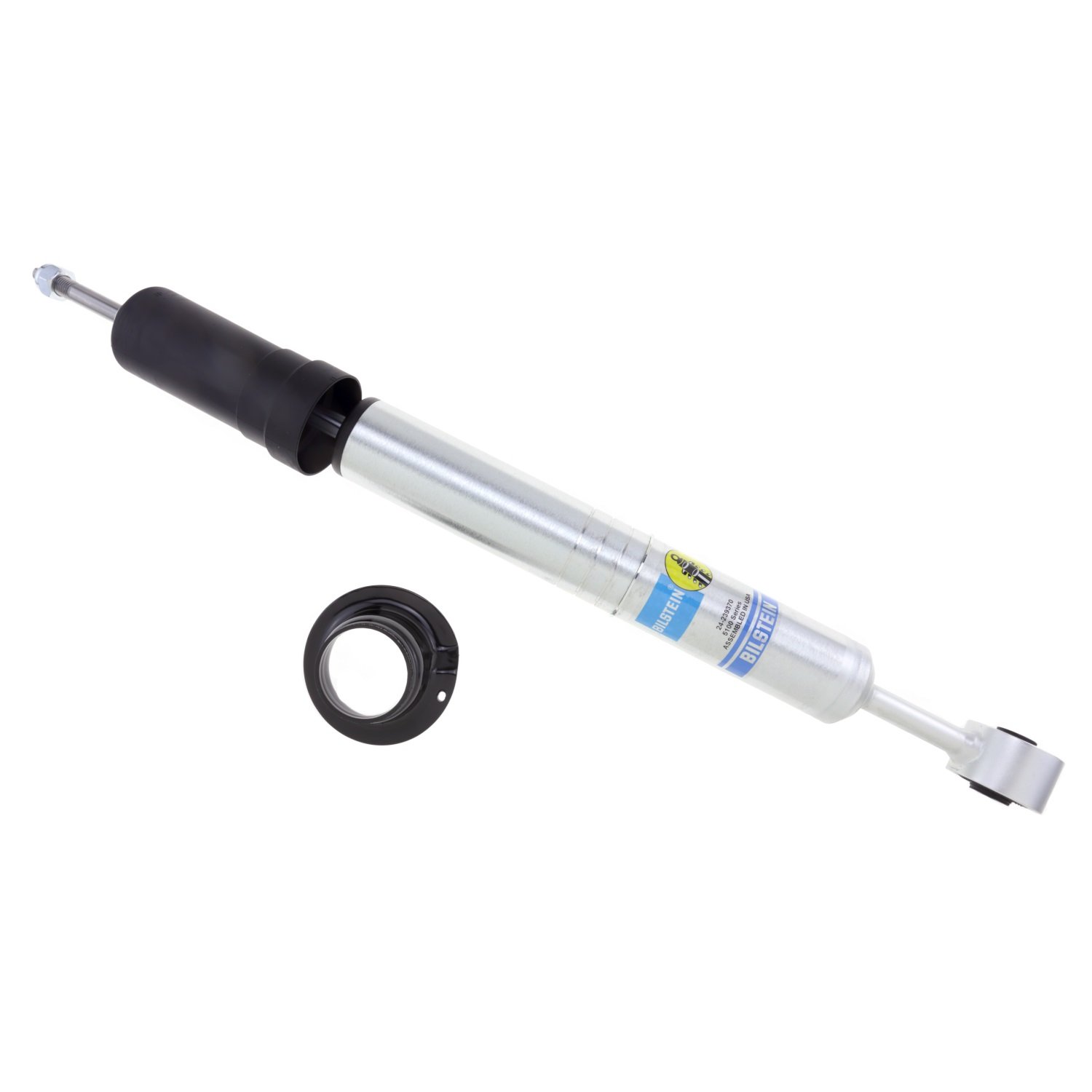

all of the websites that offer the 5160 and the bilstein site specify 0-2" lift for the 5160
You'd be correct. I spoke with someone at Bilstein yesterday an they confirmed this.
Indeed, their site says 0-2" for 4Runners.
I also noticed BillsteinLifts listing them as 0-1" for Tacoma or Ram.
The specific range aside, what Shock Surplus told me when I asked was that the 5160 bad rep is not deserved and that problems usually happen when people have too much lift for them. Apparently, I somehow made up the 0-1" range myself.
So, the question is whether people using the 5160 within the specified range have had too many issues.
