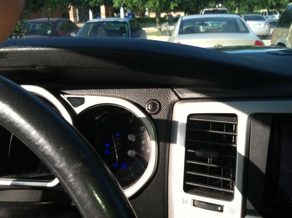

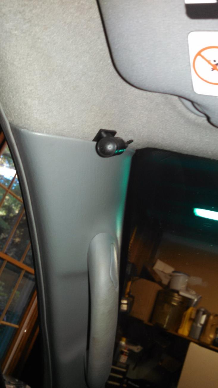

Most of the ones that I have seen have been installed by the visor. I, on the other hand wanted one directly in line of site with my mouth so that I do not have to tilt my head at all and just drive normally. I installed next to my gauge cluster using a rubber bushing that I purchased from FRYS. Man, it works like a charm. People hear my voice with no issues, even with the windows down. It's also an easy location for installation. Just a suggestion:
Mine is up by the rear view mirror. It's a relatively new Pioneer Bluetooth setup and the people I've talked to several people over it and they all say it sounds great. You don't have to tilt your head or raise your voice LOL

I have mine above the steering wheel, clipped to the circular trim surrounding the speedometer. It's convenient because the wire runs directly into the steering column over to the head unit, very minimal routing of the wires. Plus, it's positioned nicely for my voice to direct towards the microphone. Haven't had any issues since December.
The picture below is from [MENTION=87687]LTDSC[/MENTION], mine is mounted on the little silver trim right above where this one is positioned.

Yup, that's about where I have mine, too. Steering wheel, right next to the Scangauge II. Seems to work fine there. I ran the wire back behind the dash and up the side of the steering column.

+1 on this location.
