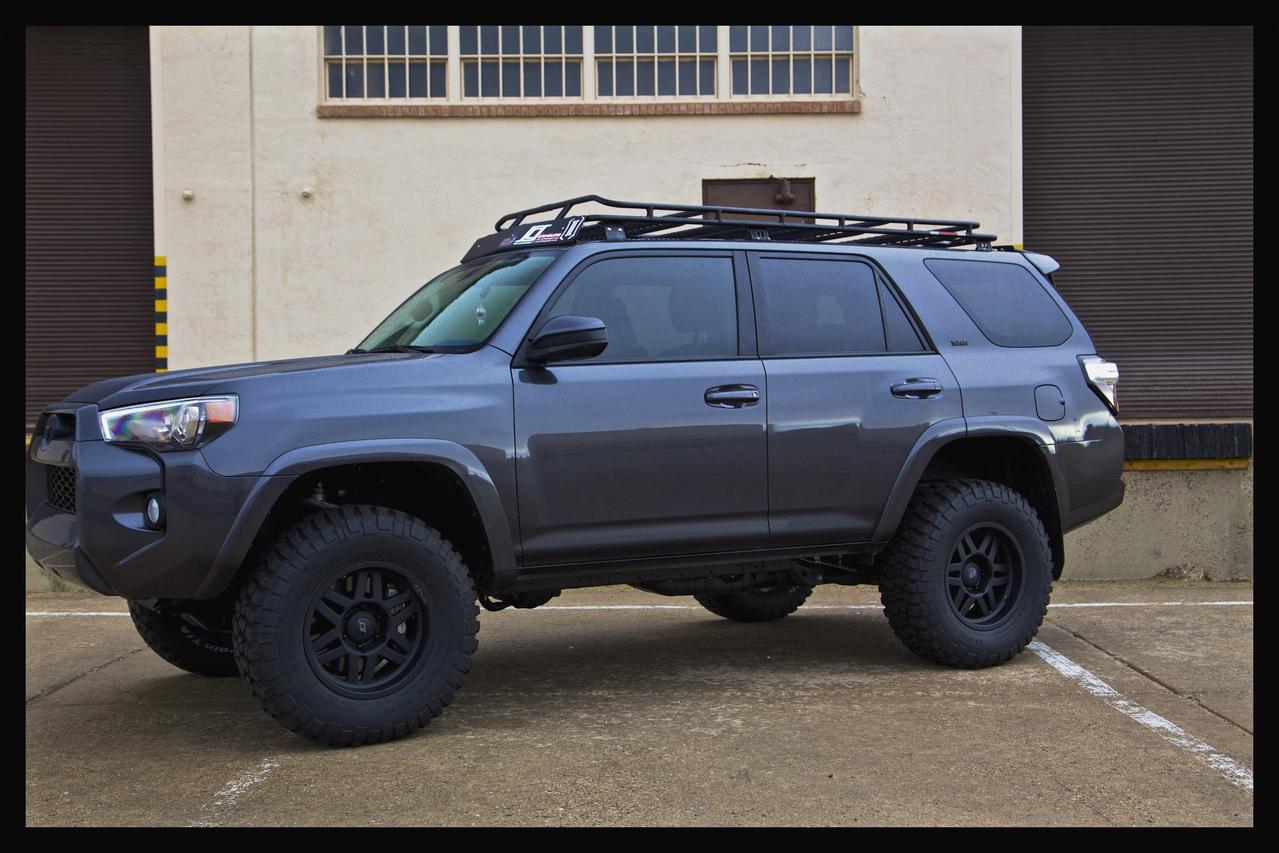

I have [MENTION=66624]KCcarguy[/MENTION] to thank for choosing the Method 301's, his rig and build inspired me.
Looking good! :cheers:
Always thought the MR301s had just enough silver to compliment the chrome on the SR5/ LTD. Also, the width and offset give the PERFECT stance!

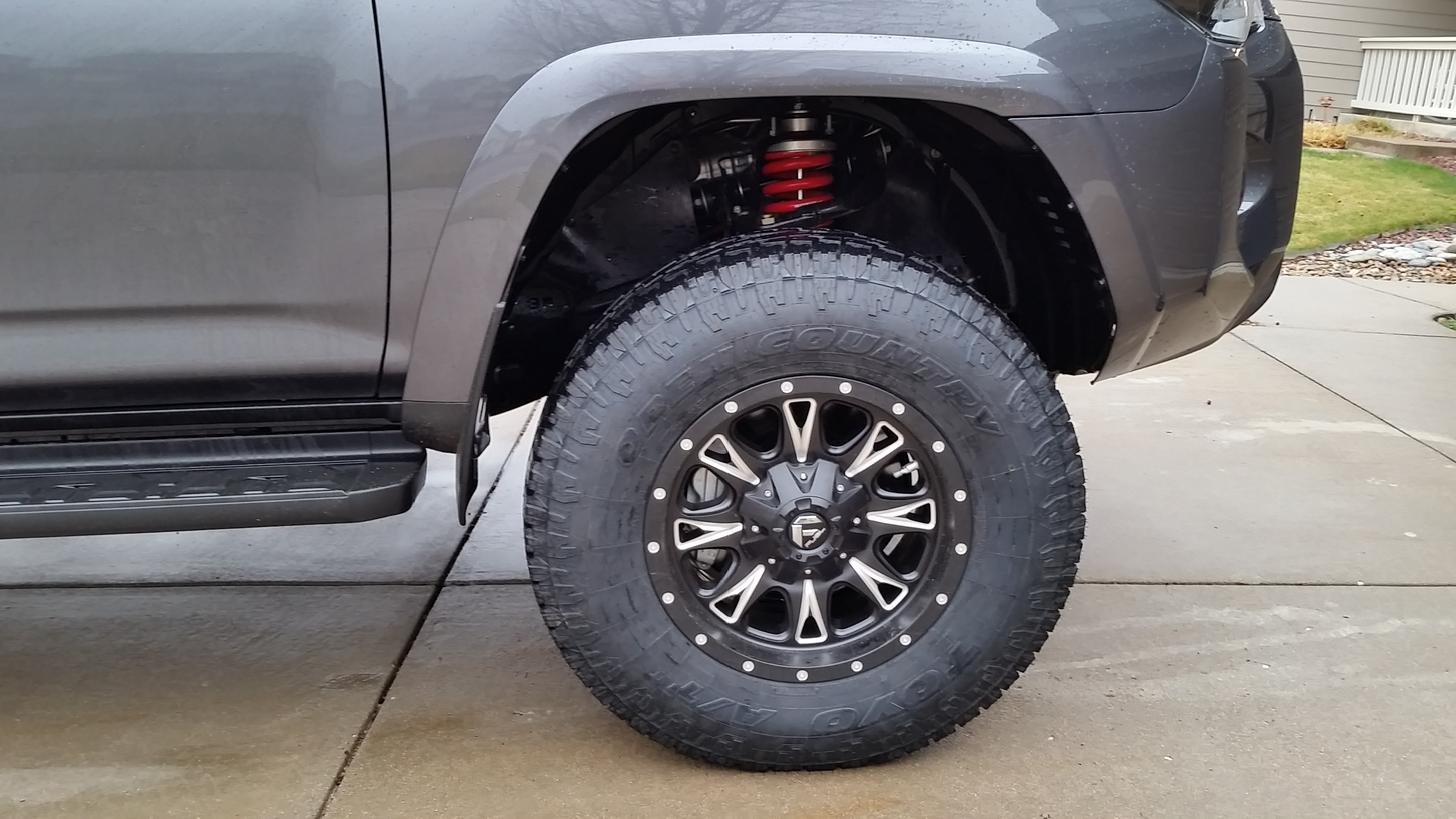

I have [MENTION=66624]KCcarguy[/MENTION] to thank for choosing the Method 301's, his rig and build inspired me to go this route with my Limited. I'm going to level it soon, but here's some pics with the stock suspension for now, love the new look with the AT's.
Great looking rig. What offset are you running?
Love the Fuel Throttle.

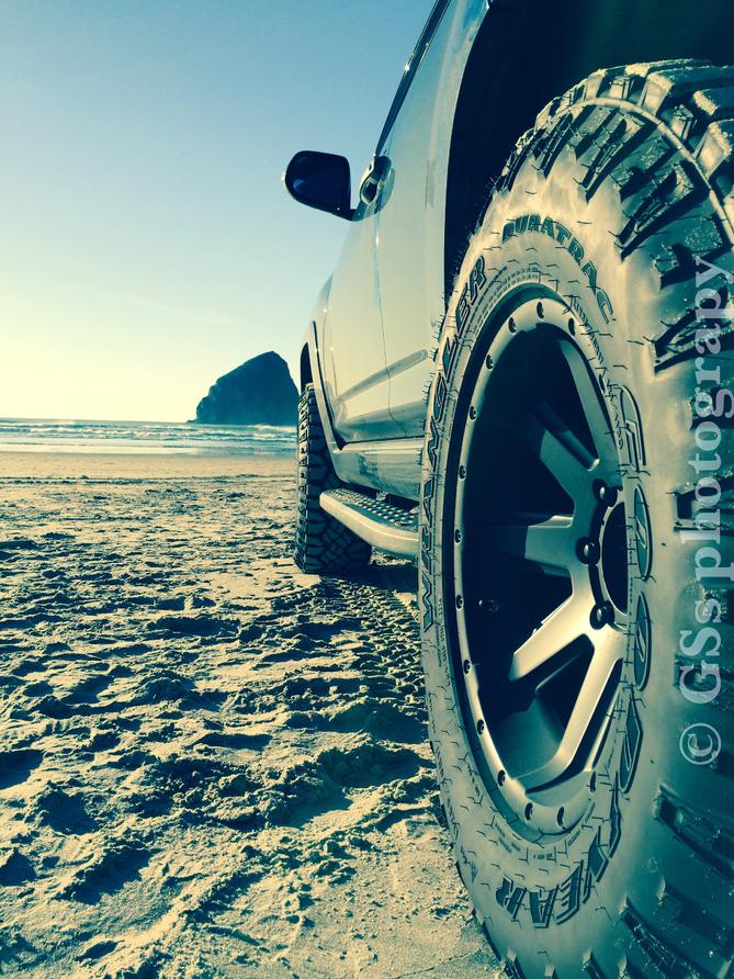

Here is another of the SCS Stealth 6 in matte black... love SCS had them on my tacoma and never once hesitated on what wheels to get for my 4runner

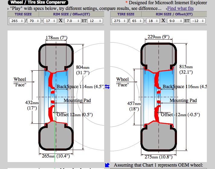

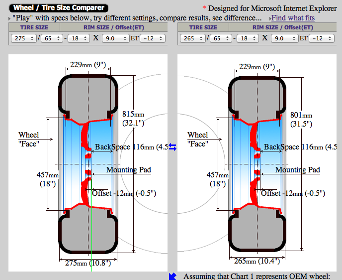

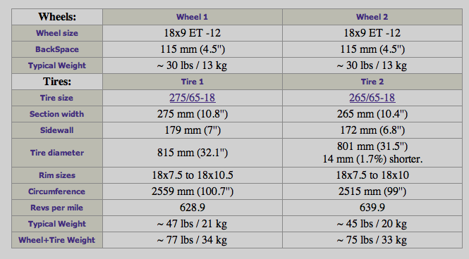

the 265 has slightly smaller sidewall (lower profile) and has slightly smaller overall diameter.
You can use this website to compare sizes
Custom rims, wheel tire packages for your ride - RIMSnTIRES.com
