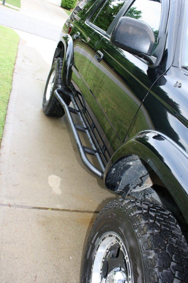

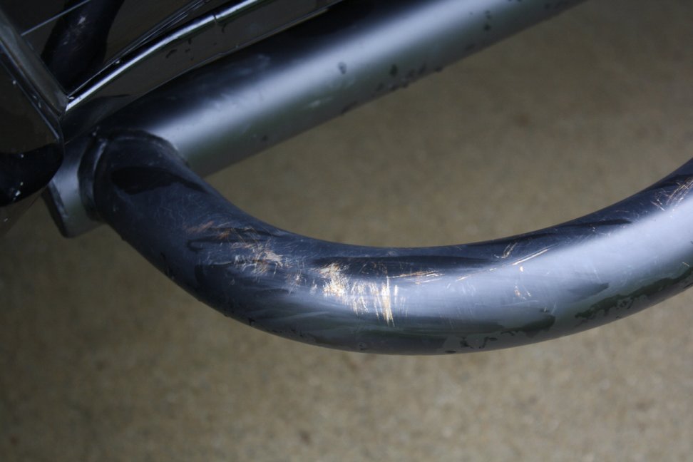

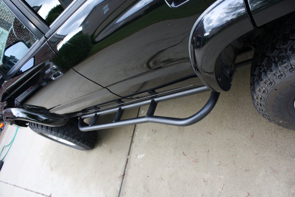

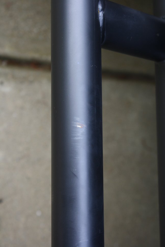

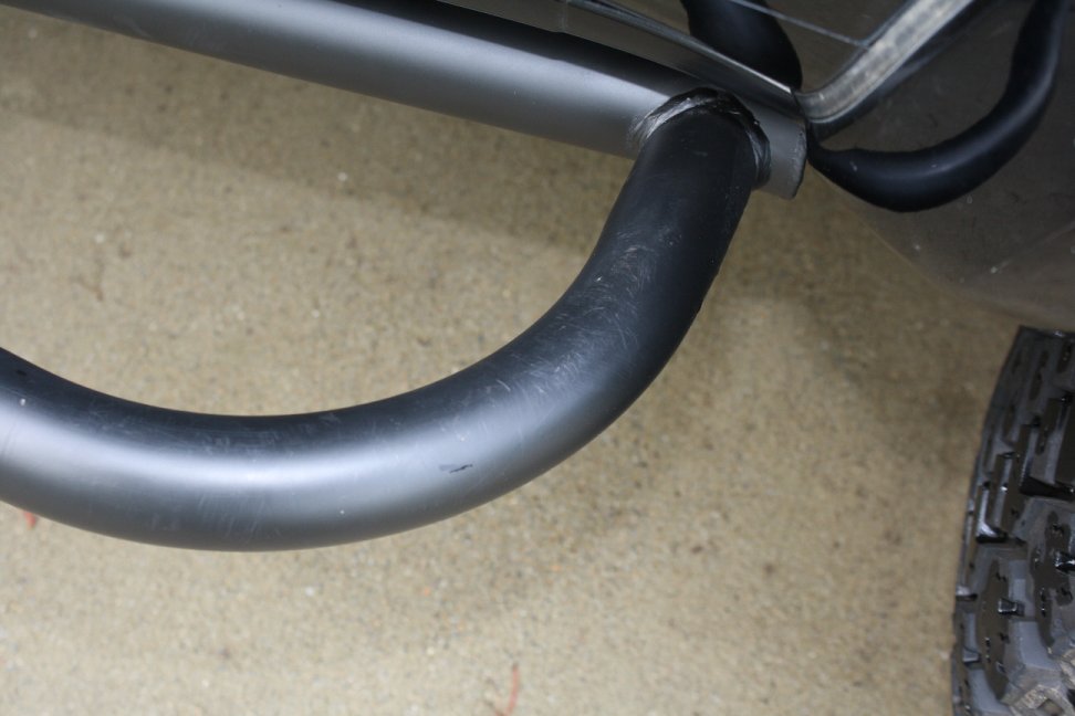

Pics (as promised!)
Well, here are the pics...I had just washed it, thus the water on some. One spot is obviously worse than the rest...baseball cleats.
Thanks for the advice...yeah, not looking forward to taping everything off. Not to mention I can't get it in the garage anymore without taking the roof rack off.
Just don't want them to start rusting...can see a little already, me thinks.

judging from the pics I would say you are good on this rust, it looks pretty minor. Out here im California you could leave it like that for a year with no perm damage.
