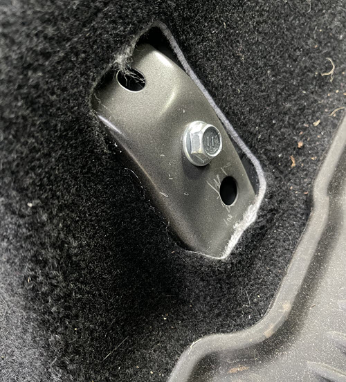

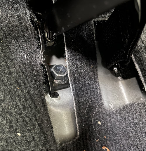

Hello.
I am looking at taking advantage of any of a couple of interior locations of my T4R5G for grounding as opposed to bringing a 15-ft 6 gage wire all the way from the startup battery for a dual battery purpose. There are a couple of spots related to the rear seat - one that supports the rotating seat bottom and the other is at the bottom of the back side of the rear seat. They both look similar in that the bolt is attached to some sort of gray metal.
Has anyone checked any of these two spots for grounding fidelity? If I want to measure the resistance using a multimeter (per earlier discussions), how do I do that? I am guessing that a long enough 6 gage cable attached to the battery's negative terminal need to be brought to the spot in question and then the resistance, R1, of that cable length be measured. Then the resistance between the spot and the end of cable, R2, should be measured, and the difference between R1 and R2 will be the resistance associated with the spot being considered.
Does this make sense? Is there a better way?
Thanks in advance.
