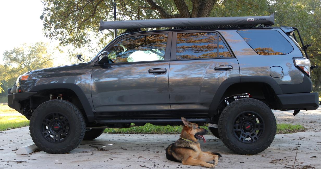

I've ran a few different setups in the rear, and there are definitely trade offs with each setup, but a variable rate spring has met my needs:
Bilstein 5100 w/ stock springs & 1" spacers: comfortable/smooth but could not control even 100-200 lbs add'l cargo weight
Bilstein 5100 w/ ToyTec 2" superflex: noticeably stiffer without weight, super comfortable/smooth with 100-200 lbs add'l cargo weight
King w/ Dobinsons 3"+ C677 dual rate springs (157-230lb): seems to provide the pro's of both previous setups. the lower rate provides a comfortable response to bumps/dips/holes and the higher rate provides control and minimal sag with add'l weight and/or towing. I really like this setup, but may be more lift that you desire - the C675 are the same coils just physically shorter and they have a ton of other options for all kinds of scenarios
