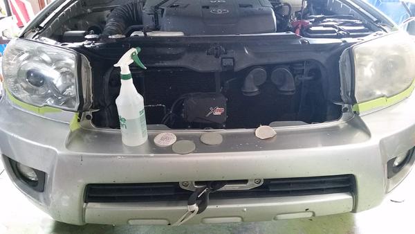

Here's step one in the process, getting rid of some of the haze on the lenses.

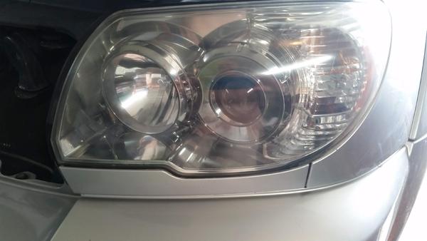

The side-by-side after doing the passenger side:

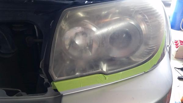

Here's a closeup of how rough the driver's side was to start with
I think I did a bit better job on the passenger side (it's crazy hot in the garage today). Overall not a bad finished product.

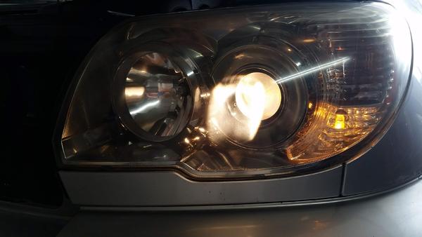

I still get a "hot spot" where the lens isn't optically perfect, but it's much better than before. The whole lends was kind of a weak yellow glow.

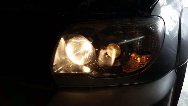

...and another shot with the high-beams on.
