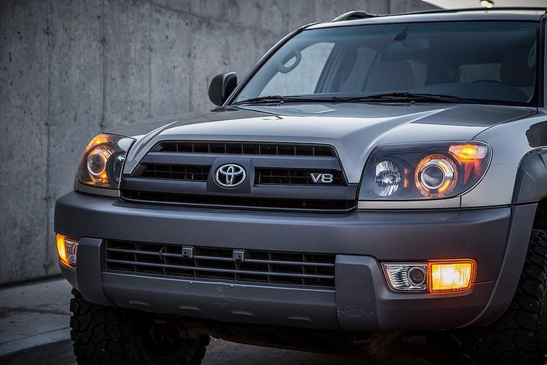

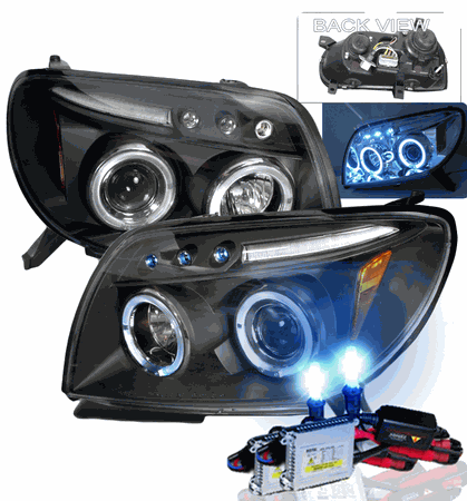

i got the Black Halo Projectors with Angel Eyes and I love them. They look great on my black '03 SR5. I havent taken pics yet but I was gonna do that today. I plan on posting the pictures when i have them. the halogen bulb is also much brighter than the stock headlight. and so far i have recieved nothing but compliments about them. also, i did not purchase the HID kit with it because i am not crazy about the blue light
