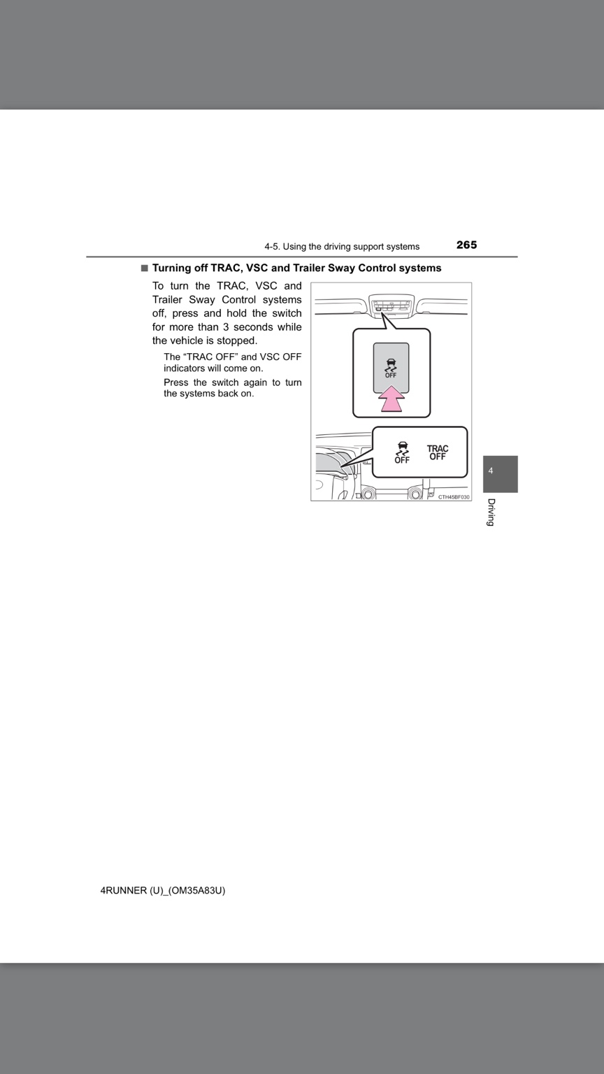

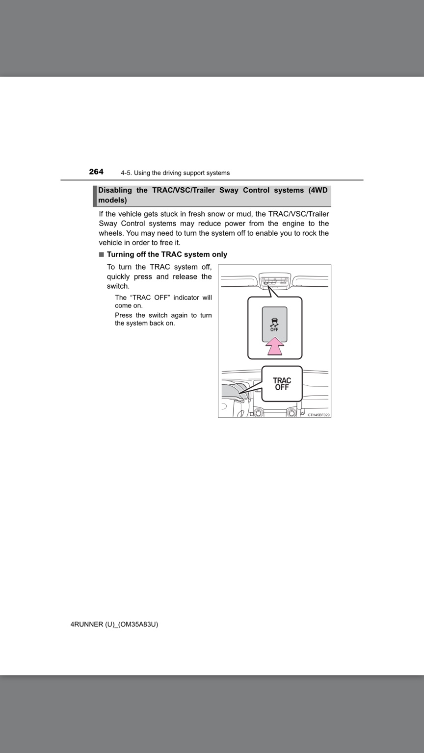

So I should hit the button once or hold it to turn everything off?
Push the button ONCE to turn off ONLY the traction control (tires can spin in a straight line, but VSC will intervene when sideways slipping is detected.)
Hold the button for THREE SECONDS to turn off ALL VSC features. Let's call it OSDM (Old School Doughnut Mode.) [emoji106]

I wish some could make a custom OSDM (Old School Doughnut Mode) switch to replace the traction control button. I would buy that.
