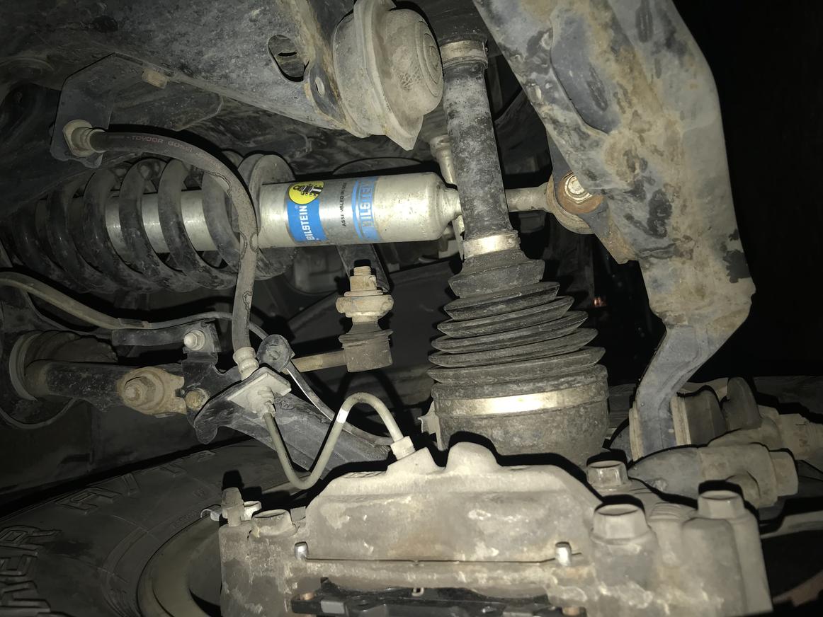

So I know this is a old thread but I’m curious to if this runner I’m looking to buy has 5100’s? I looked under the truck today and I noticed these shocks and can’t figure out if the are From the factory or if someone put theses on.
They were put on by someone.

Thank you! I went to a service shop today and they said if they were put on when the truck was new they would need changing since the truck has 90k on it but that still seems like low miles to change shocks and struts. I will contact the owner to see when he put these on. Thank you for the input it’s much Appreciated
