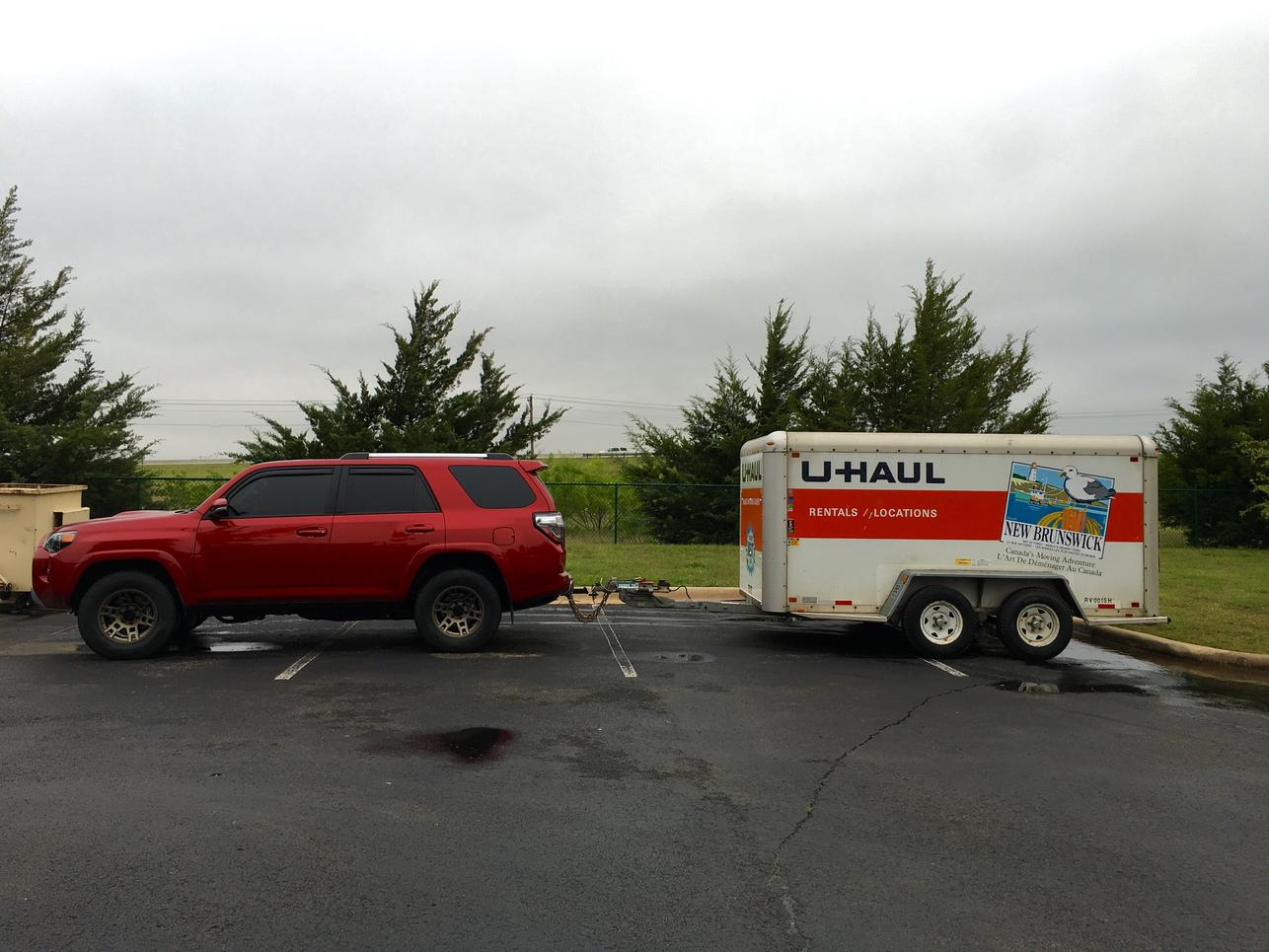

I just towed a 6' x 12' U-Haul trailer (moving my Fiance from Abilene to Denver) this weekend. Averaged 15.72mpg from Abilene to Denver (surprised the mpg was that good, but that is what I hand-calculated).
I'm happy to hear the 4Runner did as well towing that 6' x 12' uHaul trailer. My fiancé and I are ironing out our move to San Diego in the fall from Tulsa (1400 miles). I wasn't sure if I wanted to put my new 4Runner through that, but I definitely feel a lot better knowing that you had a good experience doing so. I will however install either the Airlift or Firestone airbags before our move.
What was your cruising speed, were you able to make it 5th gear?
I kept the cruise set at 67 or 68, had a few instances where I had to get around pokey-mcpokey-nuts big trucks and would run up to 75 or so to get around! Kept it in 5th gear except when climbing a hill or getting around vehicles.
Lucille did a fantastic job towing the trailer! :jump:
That's great, i'm glad to hear our 4Runners are up for the job! Thanks for your review!
