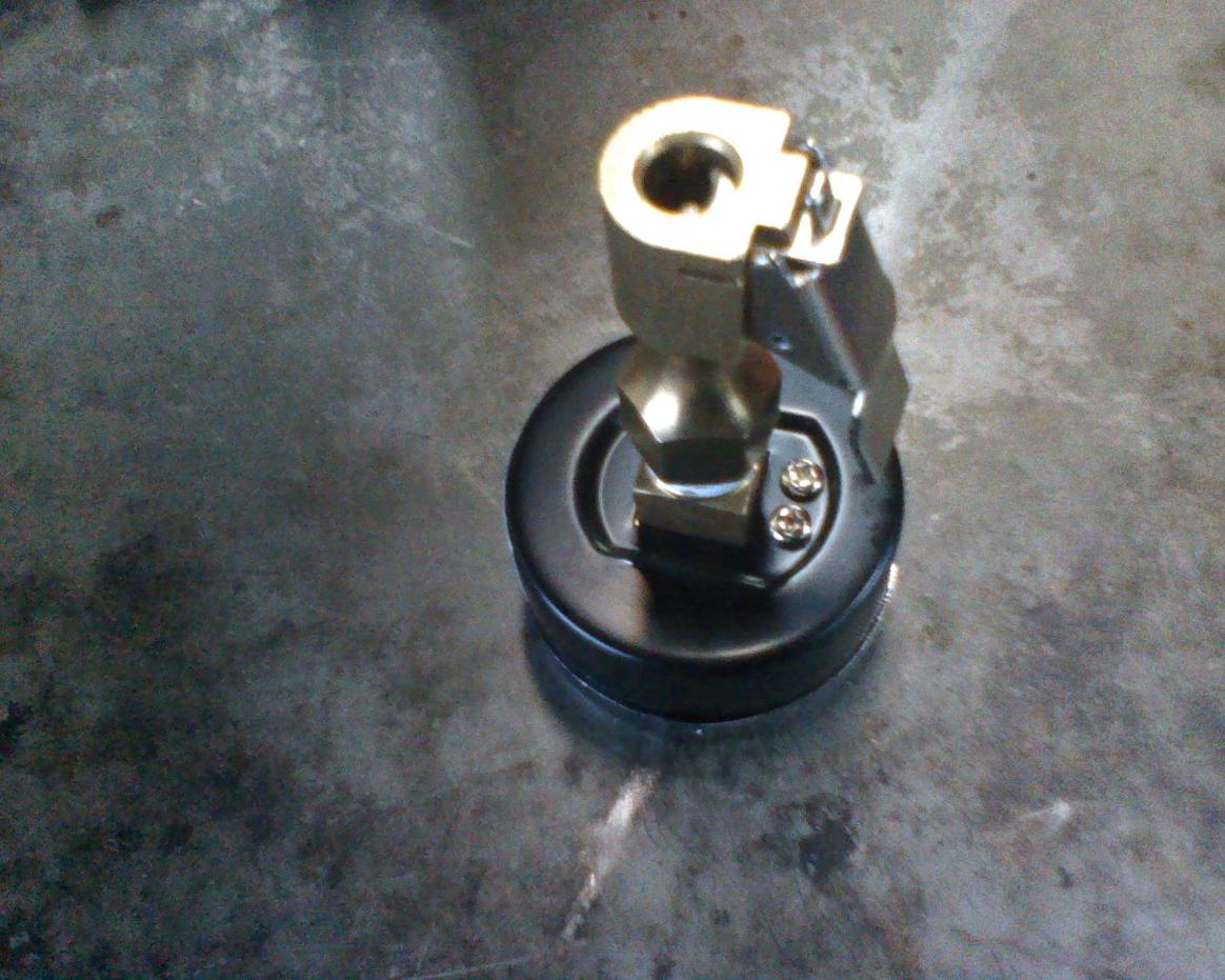

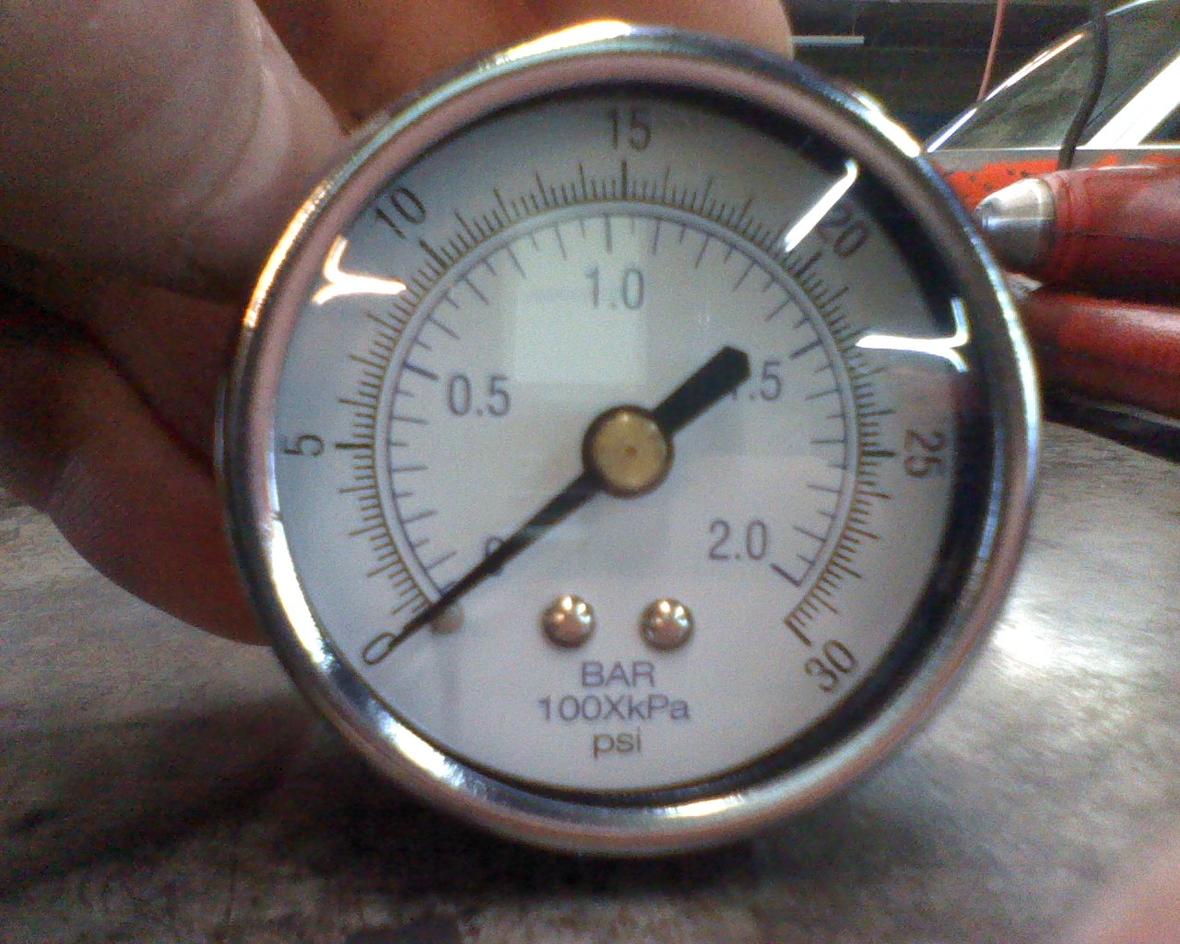

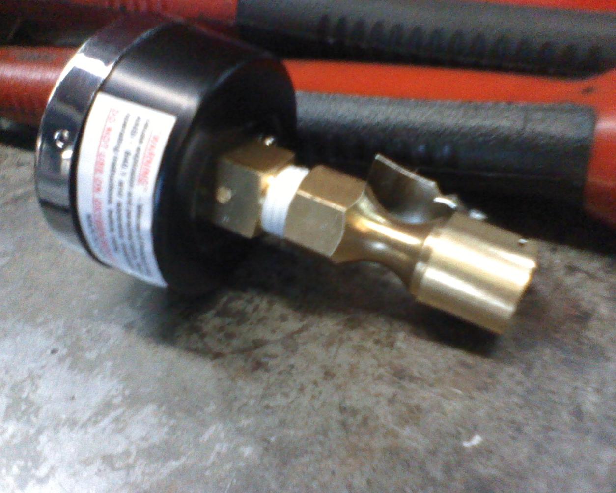

I am currently building a low pressure gauge. right now im just using a cheap gauge I found on ebay, if it works out, then I may upgrade to a higher quality gauge later.
im using a 2" round gauge, with 1/4" npt fitting. then using an elbow connecting an air chuck head. I will be using a clip on chuck, but you could just as easily connect a momentary chuck.
I think going this route will allow you to use a much higher quality gauge, and configure it exactly how you want it, for less money.

here is what I ended up with.
excuse the crappy cell phone pics...
this is meant to be a clip on chuck, for use when airing down tires, but it could very easily have been made with a momentary chuck head. in fact, this one could be converted over simply by removing the lock.
