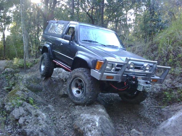

so i recently just purchased a bone stock 88 runner and want to up grade it to wheel it iam 16teen and on a very limited budget and want to know what the best upgrades i can do are and yes its my daily driver i want to keep the ifs i hope it to look like the attached photo with a bull bar and a winch and a spare tire rack off the rear bumper. Its got the 22re with a 5 speed manual with 150 thousand miles

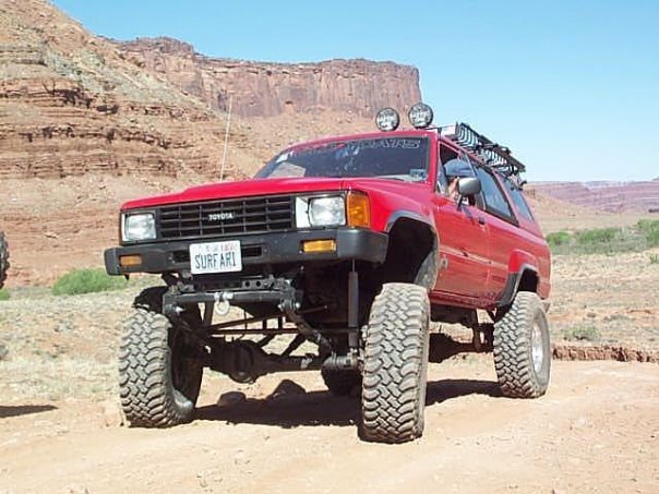

My 86
I've had my 86 for about 15 years now!
Over those years It's been through a couple of transformations!
When I bought it in 1992 I installed an Add A Leaf in the rear to get rid of the sag, Installed Rancho RS 5000 Shocks, Pre-Runner bumpers, Polished alum. wheels, 30x10.50x15 Pro Comp M/T tires, custom tonneau cover, re-upholstered seats, and drove it!
After attending a few Moab Jeep.... I mean... TOYOTA Safari's and, joining the WILDYOATS 4x4 club, I decided to trade the IFS for a SAS... Thanks to ROCK LOGIC 4X4 for opening their shop about a block away from my house and after spending about $5000 for all the goodies such as...
SAS, Toyota E Locker, U-Bolt flip kit, Extended Alcan 4" springs, Cross Over Steering, Long travel Doetsch Tech Shocks, FJ 40 Rotors, 35" BFG Mud Terrains.... Hell, I can't remember everything!!!
But you get the idea! Over the years I've put about $10-$12,000 into it...
and it's always been my daily driver.... NEVER a trailer queen!!
I'll tell ya..... It's been worth every penny!!
The first pic... the day after ROCK LOGIC 4X4 finished the SAS(March 2003), at the WILDYOATS... YOTAFARI in Moab, Utah
I can tell just from looking at that picture that this truck is lifted. To much clearance on the front skid plate.
