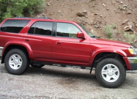

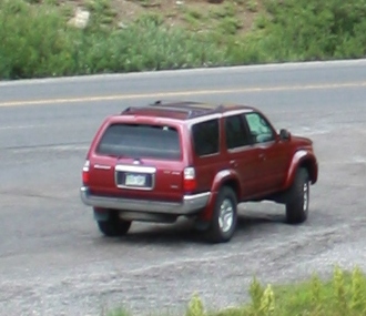

Just installed some Old Man Emu 890 coil springs today. I also put on some new rear axle lower control arms (from toytec). I like the rake alot, and it's no longer mushy like it was with the stock springs. I'll post a pic tomorrow, but here it is before, sagging with the weight of camping gear (It was worse than it looks):

Well i just saw this thread, and nice rig COShadow one of the few non limited red ones. I currently have OME 890 with the air bags in them and i love them. with my best guess ive had somewhere around 7-800lbs in the back of the car, Bikes on the carrier and a towing my jetski. It sagged about 1.5-2in, respectable in my opinion. The air lift kit i got came with blocks that made up for the my lift. I dont really use them unless i have some weight in the back, they will make the ride very stiff with full pressure. All in all i think they are a great feature to have.

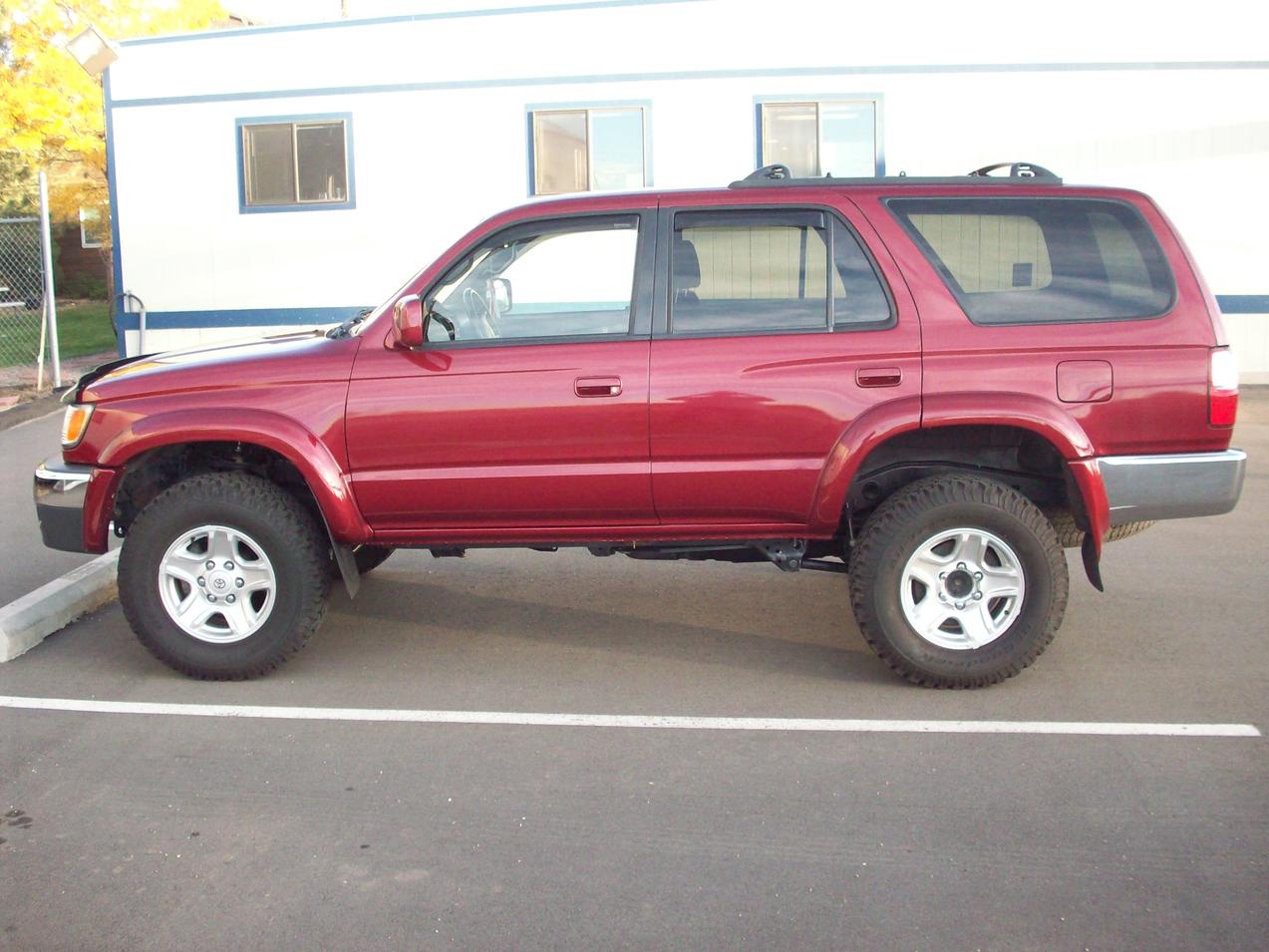

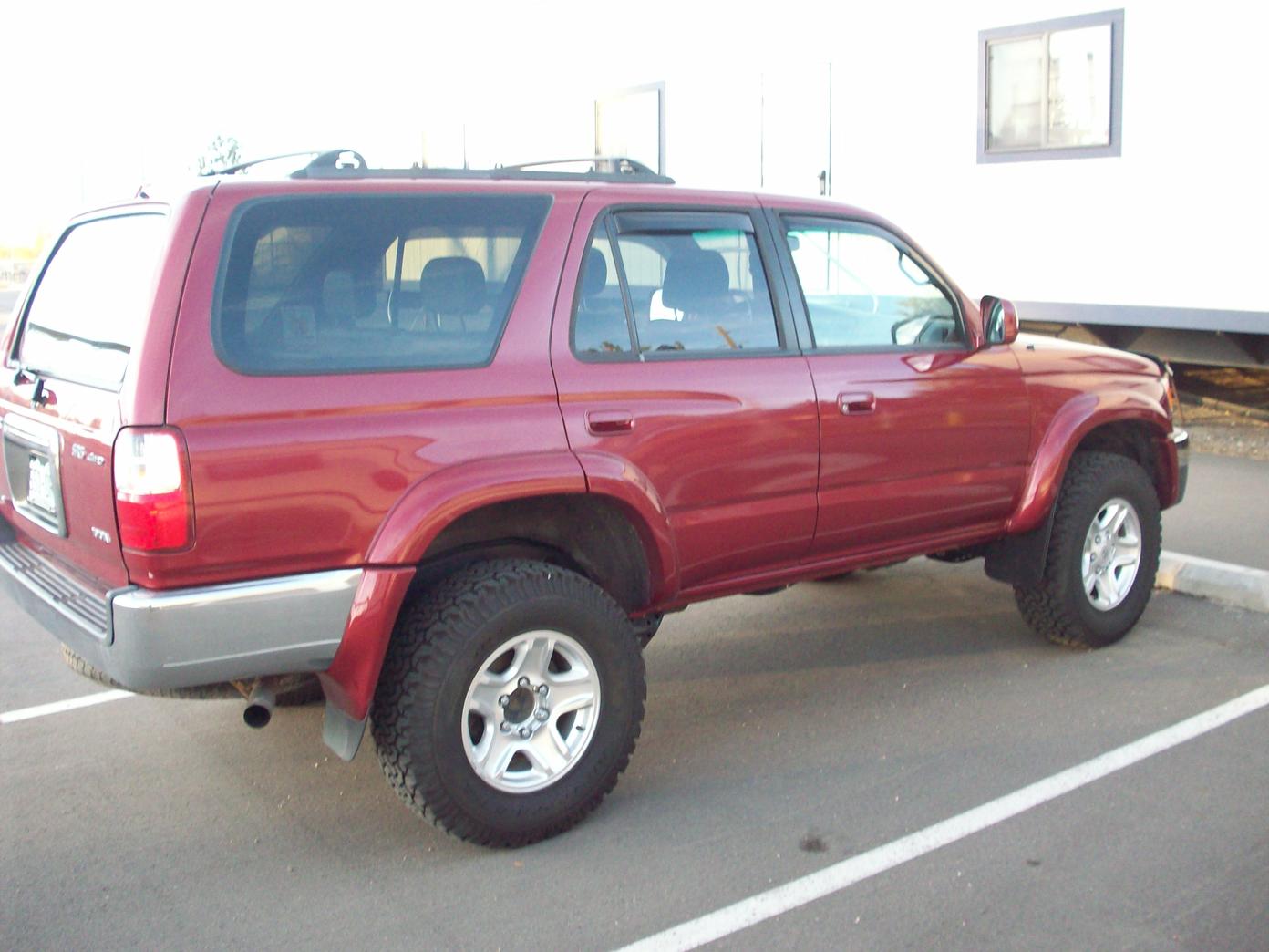

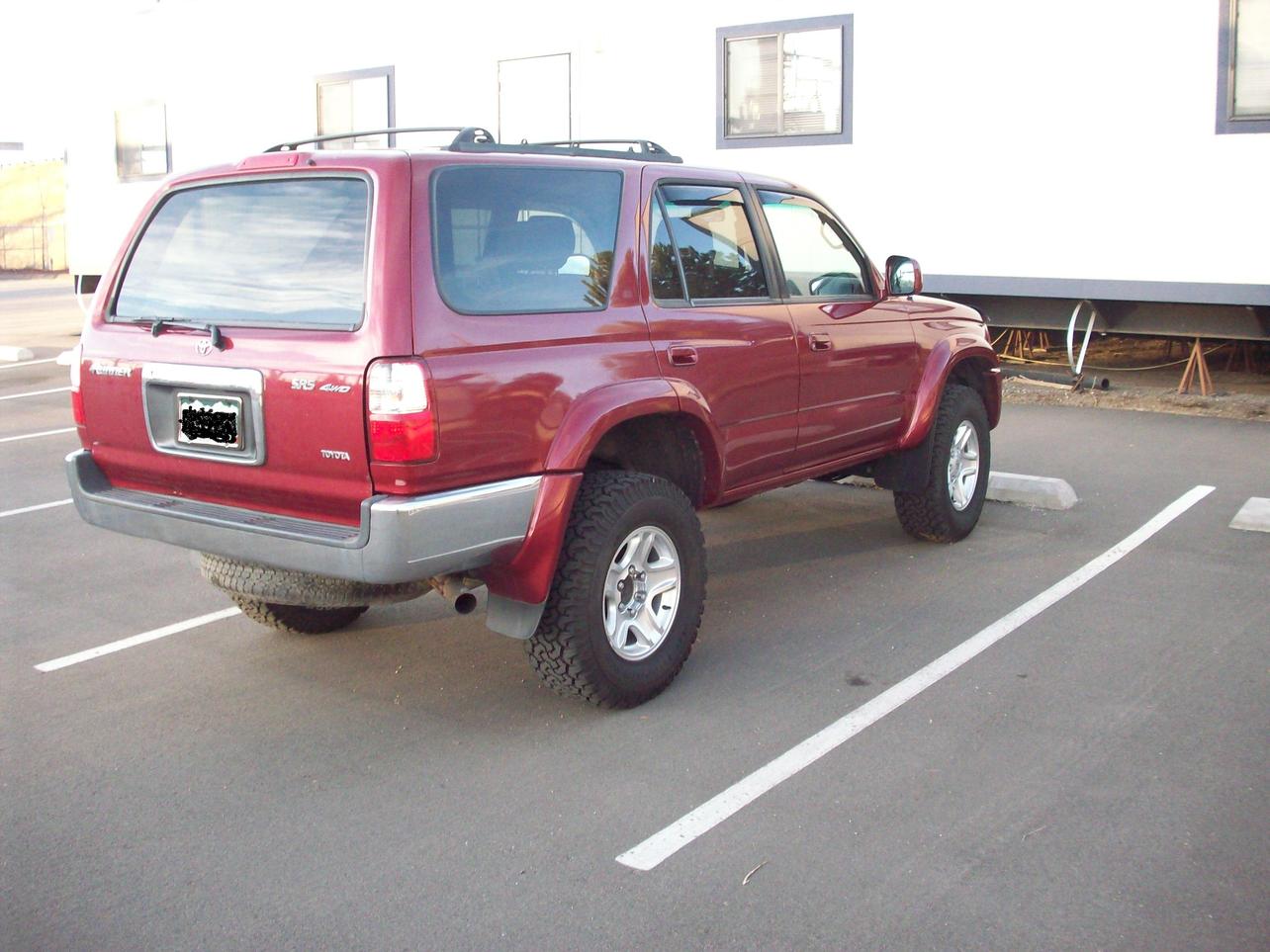

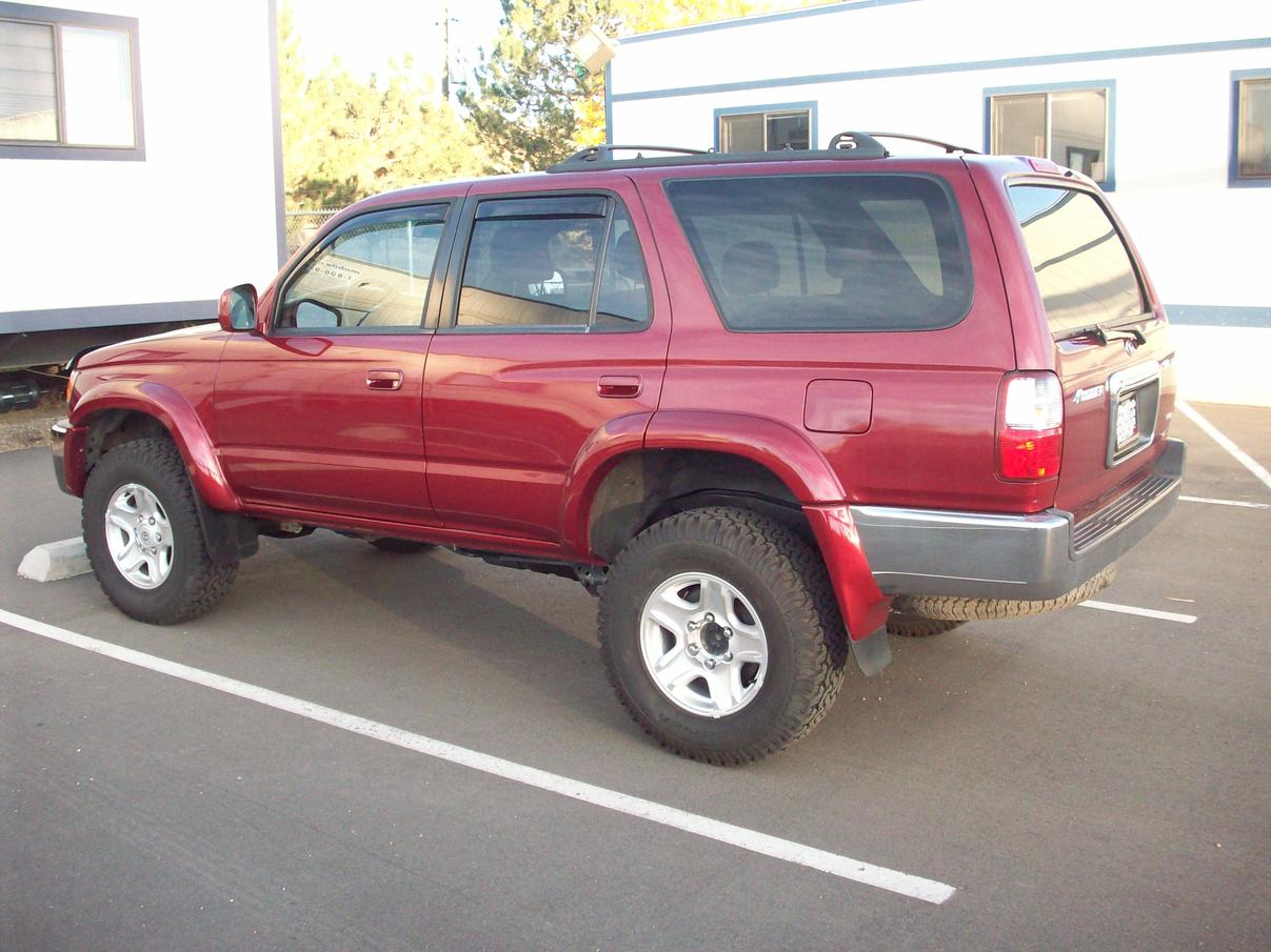

Thanks twitchee2! That first picture looks like mine used to as well. I won't be doing any towing, even took the hitch off, so hopefully I won't be needing the air bags. Here are some pics of how it sits with the '99 front coils, trekmasters all around and OME 890s in the rear. IMO, this is how 4runners should sit. Rake is my friend!

Very nice, COshadow! I like the rake, but it's a little too much for me. With the 890's in the rear, I'd be inclined to put a 1" spacer on top of the tall '99 coils in front. Otherwise it looks perfect.
So the 890's aren't too stiff with the trekmasters? I didn't know the trekmasters could handle a lift coil...
I don't think the 890's are all that stiff, but then I'm used to the OME Dakar leaf pack w/ add a leaf (heavy duty) on my Tacoma. While the OME shocks probably pair better with the coils, the trekmasters seem decent in conjunction with them (note, these are the aftermarket trekmasters, not the stock shocks). No trouble with the length of the shocks (yet anyway). I'm not sure how much the coils lifted the back, but I don't think the figure is too much greater than my '99s were when brand new (Toytec said it would only be 1" more than the '99 coils). They agreed I should be fine with the shock length.
