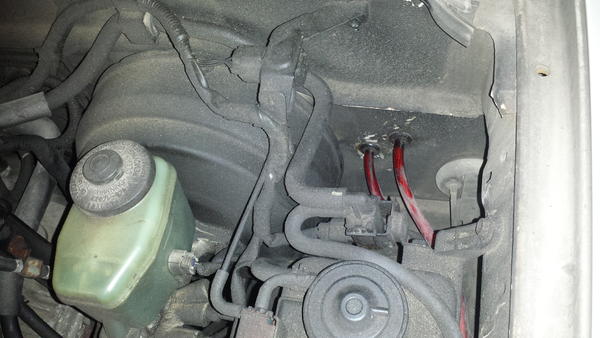

they certainly didn't change the firewall for this reason. Look at my picture, you can see on your truck if that free space still exists or not. Wires go straight to the cabin where you can hide it below the kick panel then the door plastic trims.
May I ask what tool you used to drill those holes? That was my first location for my bulkhead fitting but I sure have no drill small enough to fit there on either side of the firewall.
I'm going with a different location with it now but I would still like to know for my 2awg wire.

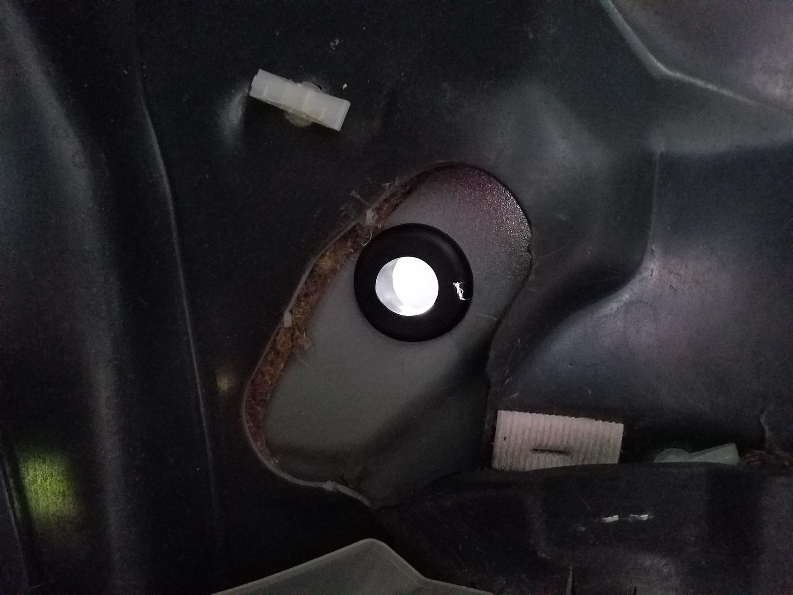

I used a step bit and hit it from inside the cabin. Depending on the size of your drill that may work better. I was able to get a fairly straight shot in that location, but it was tight. Just put a drop cloth or plastic garbage bag down under there to catch all the metal shavings or vacuum them up well so you don't leave your carpet full of metal!
Oh yeah, I know that spot well.... I think my drill is too big, even with a Uni-bit (step bit). May have to get an angle drill from work and that would work, I'm sure. Last thing I wanted to do was use a Drimel Tool and work a hole open with that. I would be cleaning debris up for weeks if I did.
But at least I know it can be done. Thanks!
