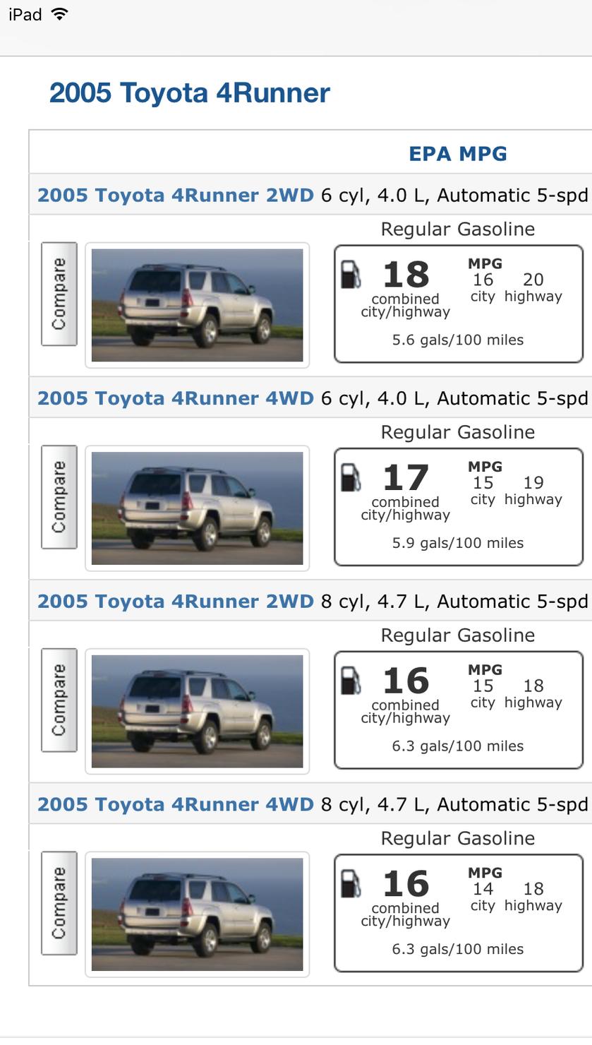

Post Note-
How much of that corn crap are you guys using in Arkansas? The ethanol stuff is crap fuel for mileage.
