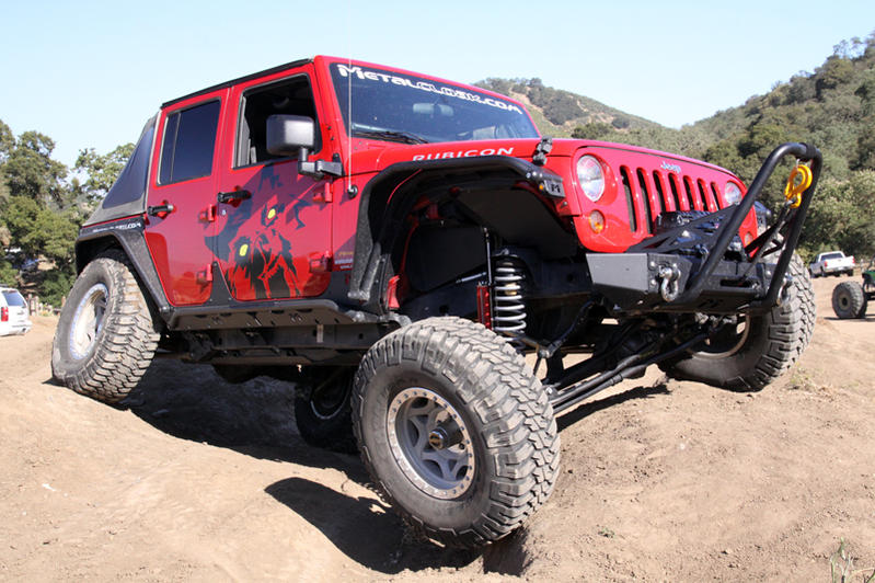

It will most likely be a 4 door. This is my desktop background for my motivation.
