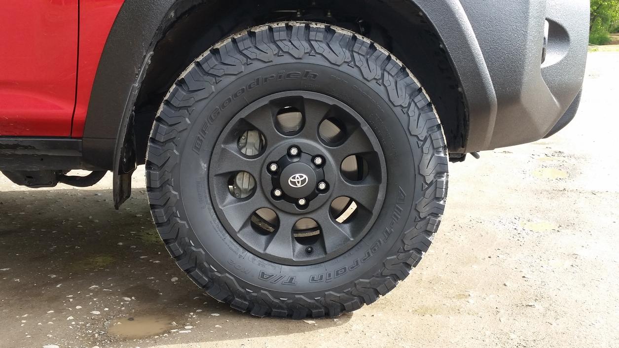

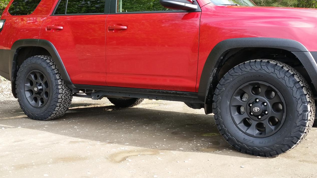

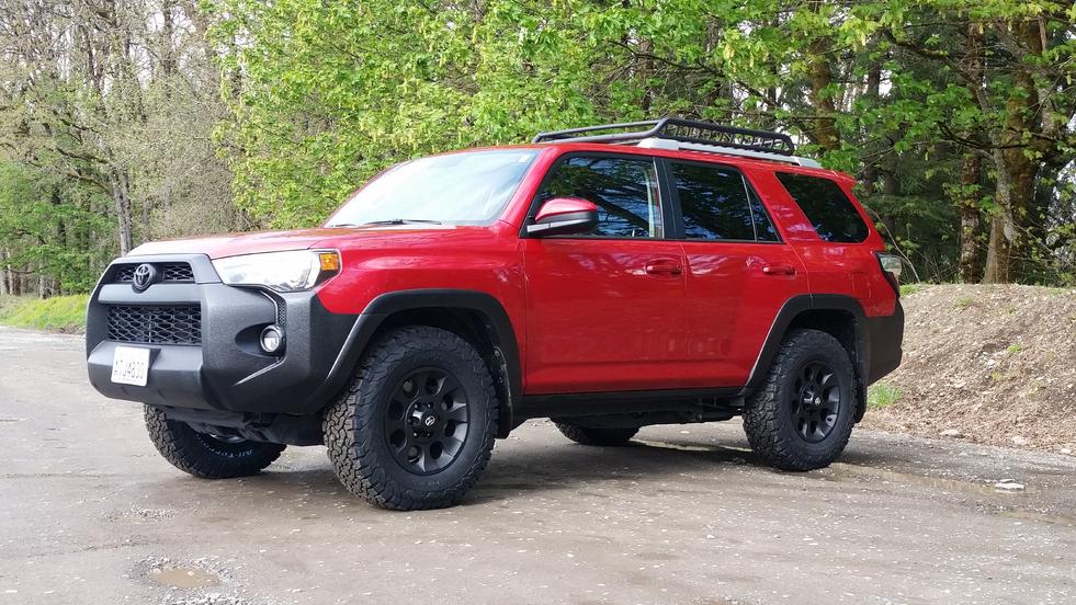

I have had mine now for a couple of months and in short, yes the ride is a little stiffer and can be harsh at times compared to the stock tires. The factory tires are pretty soft and are a much lower load rating the the KO2s. The KO2s are an E rated tire which a much stiffer sidewall. If you are going for comfort, the KO2s might not be the best. Also, I am having a very hard time getting one tire to balance. I have been in 3 times in the past 2 months in an attempt to get them to balance right. One tire was replaced under warranty after 2 weeks as the tire tech told me, "it might as well have been a square tire" that's how bad it was. I will ride with them for a while and see how it goes, but would probably get something different if I had not gotten such a damn good deal on them. Just my 2 cents. Couple of pics added, size is 275/70R17

If you get the 265/70/17 KO2 in load range c it will not be as harsh as the 275/70/17 load range e tire mentioned above but will still be a little harsher than stock tires.

That is a nice ride there Rain in red.
