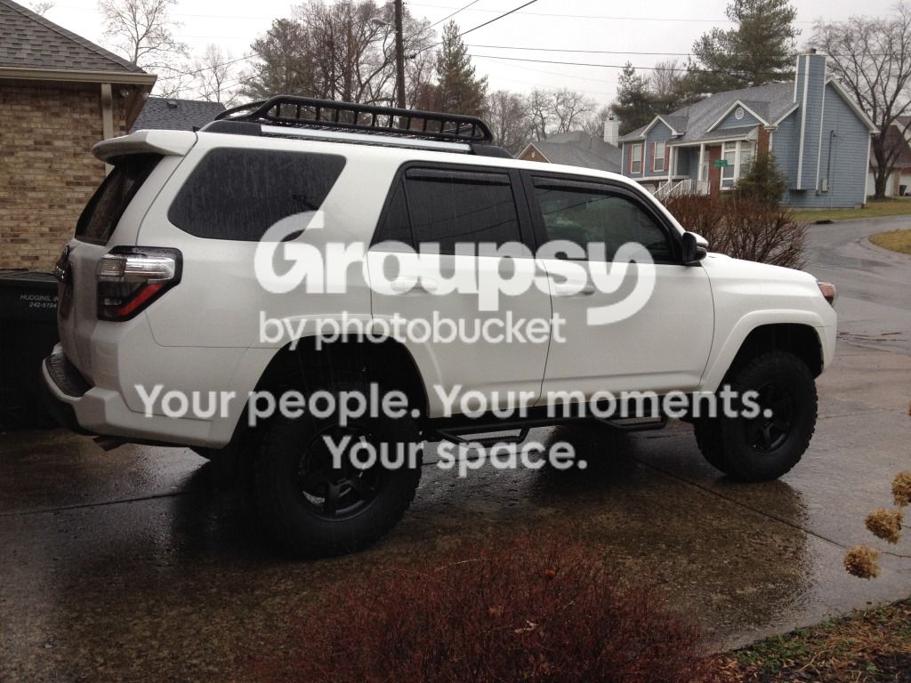

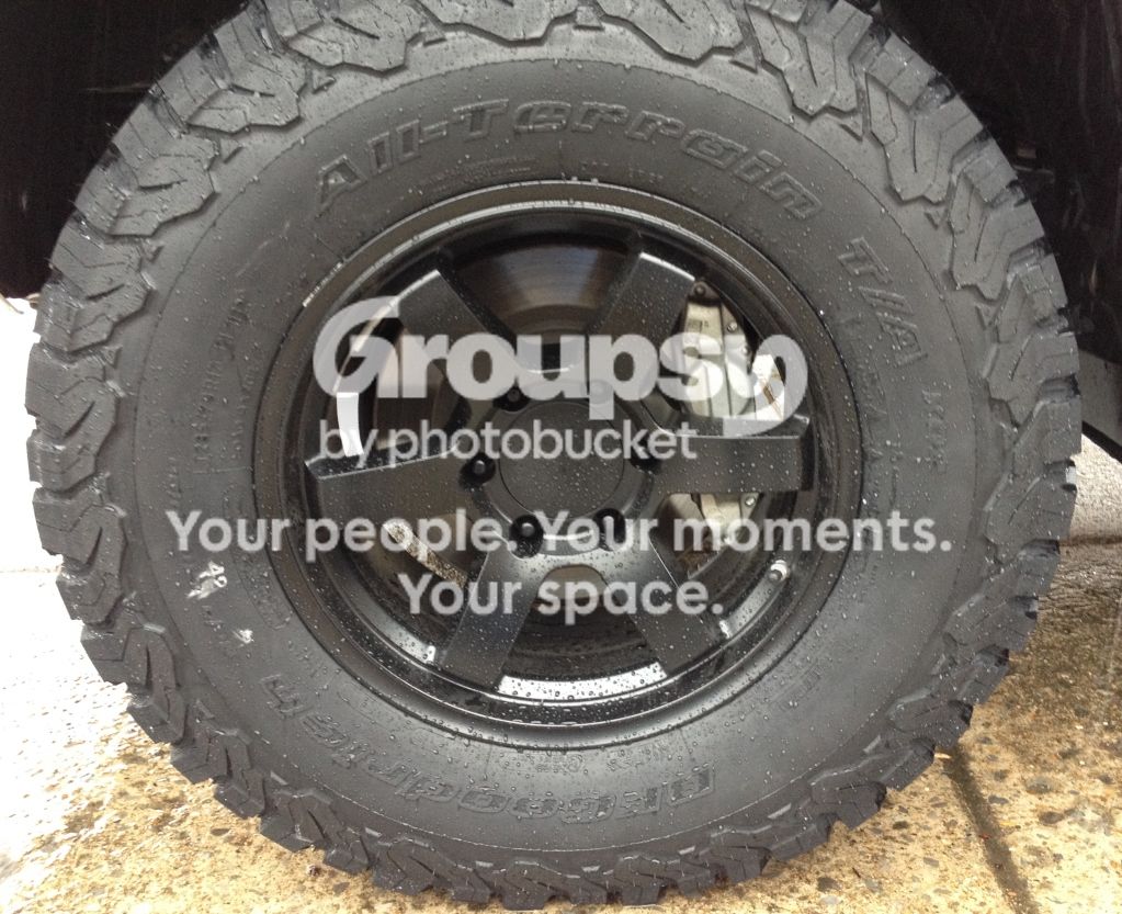

Installed my new shoes today, BFG KO2 285/70/17

Nice rig, I recently just put some KO2 but in stock size 265/70/17, I really wanted to get some 285 but it wasnt going to happen with stock Sr5 wheels. I will tell you that these tires handle great on road and off road.
Looks fantastic!
The kO2 is a solid upgrade of the KO. The mileage remains to be seen, but so far I am impressed. They have great road manners (and quiet!) but handle the trail well.
I traded in 285s, I have 265s now on the 4r and I'm happy with them. First time I did white letters out, and I think it would look badass on your rig. Justsayyin
You've got a sassy storm trooper
you can fit 285s STOCK and you have a PRO that is already a touch higher in the front
