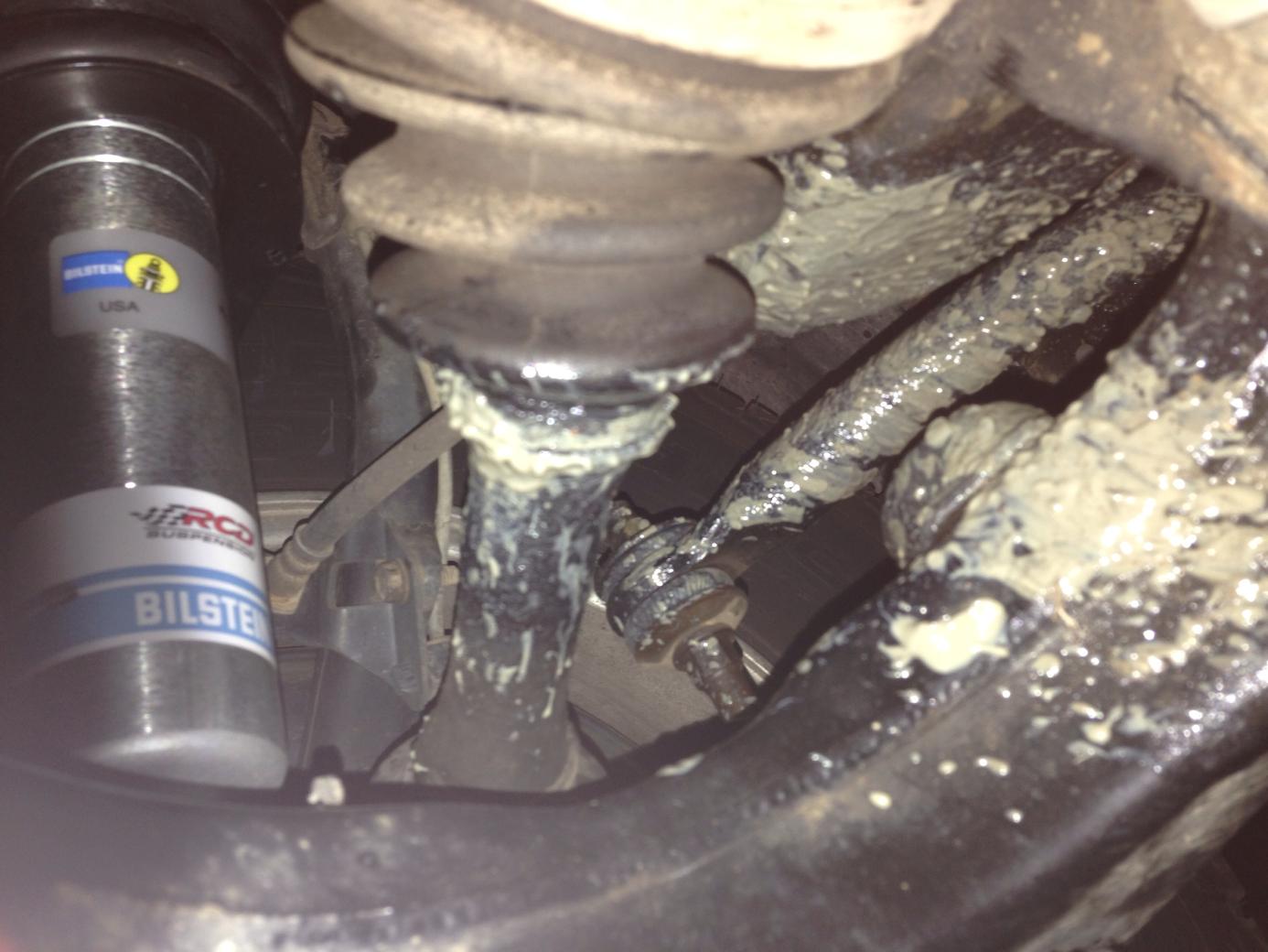

How major is this leaking from the cv boots, will this be very costly? I know it's due to them stretching and I don't have diff drop and not planning on it.. Just want to know if it's a big deal!
Not that big of a deal until all the grease leaks out, I'd get it taken care of soon but it's not major. The dealer would replace it for $2-300 or you could do it yourself for about half that.
Or you can reboot it for as little as $25. You can buy one piece boots from Toyota, or 2 piece boots from Autozone. I've been running a 2 piece boot for about 6 months now with zero issues.
It will only be costly if dirt/sand/small debris get in there and grind away at the cv s. On an non 4rnr i've had sand (on bridges w/ice) ruin a cv in less than 100 yards of travel. Felt like i was then riding on square tires. That added considerably to the cost of repair. So I (me) wouldn't wait. :cheers:
