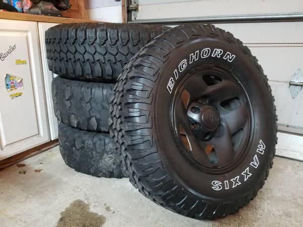

Local guy has 265/75/17 tires on 7.5W wheels. 2 tires look pretty OK, other 2 are worn down. probs ? need 2 new tires? what happens if I mount these. different rolling Rad an issue?
The AWD system on the V8 likes/needs tires that are within 4mm size of each other (iirc)
That said, those two worn ones would definitely need to be replaced imo. Looks like on any wet pavement you'd be sliding around with how worn those treads are

If you have AWD you want to match your tire diameter if at all possible. That being said a small amount of tire diameter difference won't hurt but a large amount will. Measure the two tires and compare to new (new info is on line) so you know how much is worn. As you said 2 of those are total junk and you should get a discount because you will pay the disposal fee...lol.
The Torsen T3 likes similarly sized tires (an unofficial number I have heard repeated over the years has been 3~4/32") on both axles. The All-Time 4WD system the V8 4Runners use is slightly sensitive to it, it may not blow up the transfer case. But the difference in speed of the two axles when the tires are significantly different in size between front and rear axle will cause the Torsen T3 center differential to overwork itself.
If you had 2 big back tires and two smaller front tires, your transfer case would be overworking itself. But if you had a large tire and a small tire on the same axle, that differential could overwork itself because it would think you are constantly turning (not very sharply) because the CV shafts on each side would be spinning at different speeds. The diff might experience more wear but your transfer case couldn't tell a difference. Therefore it could be better to have the taller tires at the FR and BL positions. Would this be correct?

Even if you could run all 4 of those tires, doesn't mean you should...
Two of those things are just too far gone.
