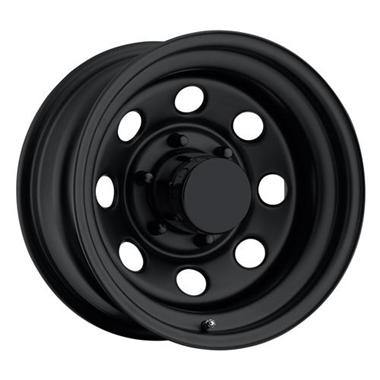

If i want to go with a new set of rims like this ones:
What would you thing that can be cheap but still good.
tks again.
