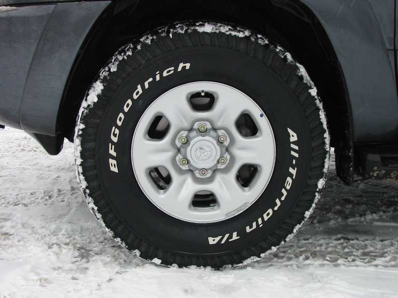

Decided to get the BFG A/T ko 275/70R16 just in time for the latest snow. Mounted them on a set of Toyota base steel wheels with matching hub caps. Got them because they are more surefooted for handling than the Dunflops and are rated as snow tires. Nicely fill out the wheel wells without any rubbing (slightly wider and taller than stock plus the beafier squared off tread) for a good look. Also gained an actual 5/8" more ground clearance.
Think twice about the noise before you put them on a daily driver. If you don't need the traction advantage of an A/T then stick to an A/S. They are the loudest tire I've had but I knew it before I bought. They sing a little at higher speeds (90+ kmh; 55+ mph) but they have a lug rumble around 35-45 kmh (25 mph).
