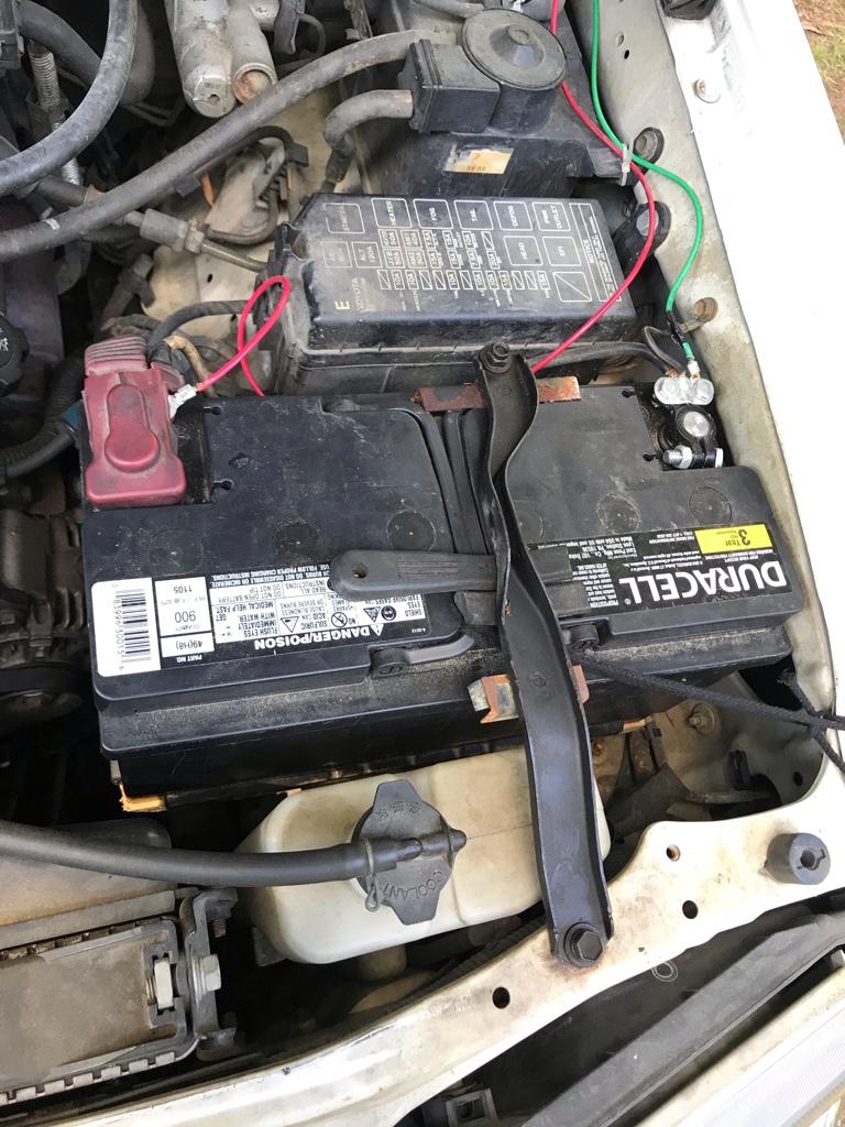

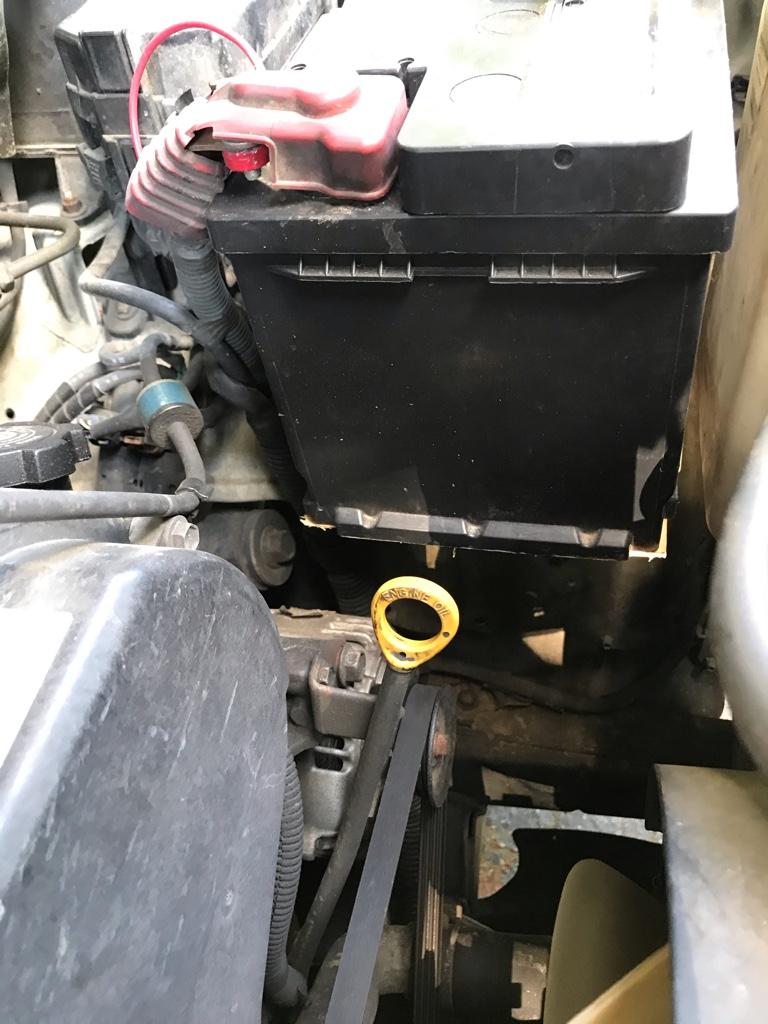

I put this one in recently because I already had it from my diesel Mercedes and it was only about a year old. I used self drilling screws to attach a beveled piece of 3/4 ply beneath it. The little rope is likely unnecessary but helps my paranoia.
Duracell part number 49(H8)
