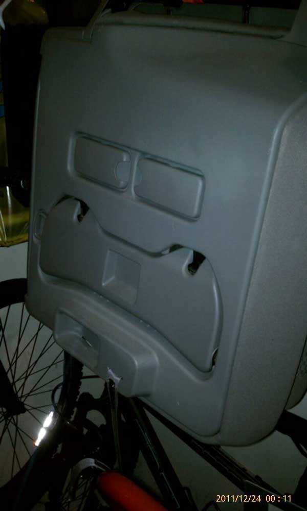

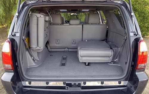

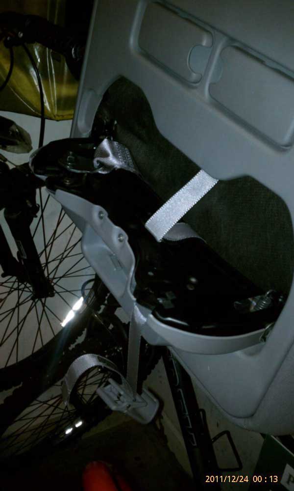

Hopefully I'm not stating the obvious: there are a set of feet/claws that flip out on the bottom of each seat and attach to the cleat in the floor area of the 3rd row. If you don't flip out the feet/claws, the third row seats will dip down in the middle. See the pics below.
