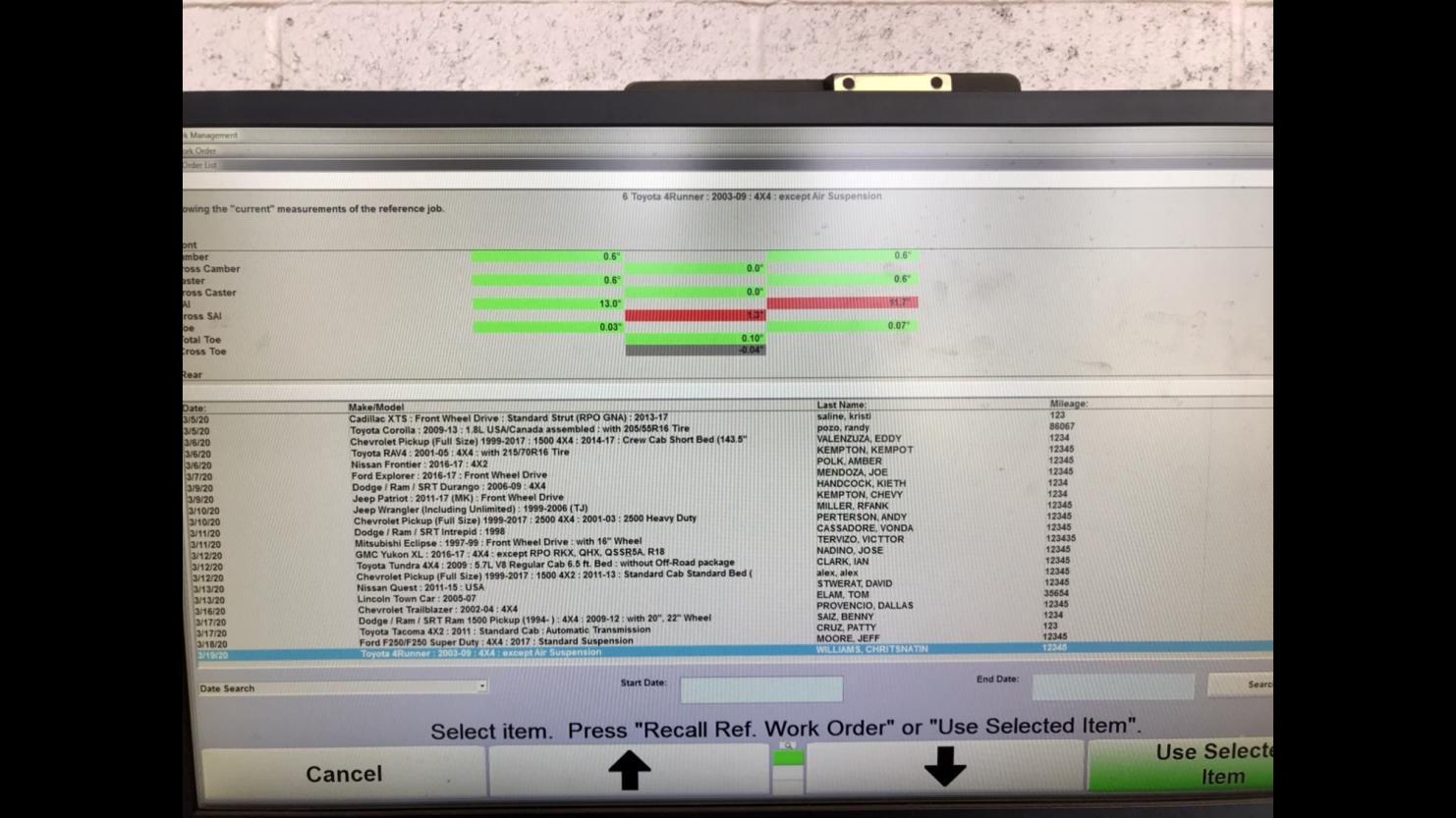

I posted on another group which said that adjustable CAs are really needed to balance caster/camber.
I have the print out from my alignment shop below.

Not trying to hijack this thread by any means, but how does my alignment look? Anything unusual or way out of whack?
you want more caster you have .6
the OP was not even to the min at 2.3
try for 3.5 or more
Oh geez.... .6*, thought I saw 6* lol. Guess I'm way off huh? Was hoping to get away without having to get new adjustable UCA's with my lift not being over 3" but guess I will have to start looking more into that. Thank you.
