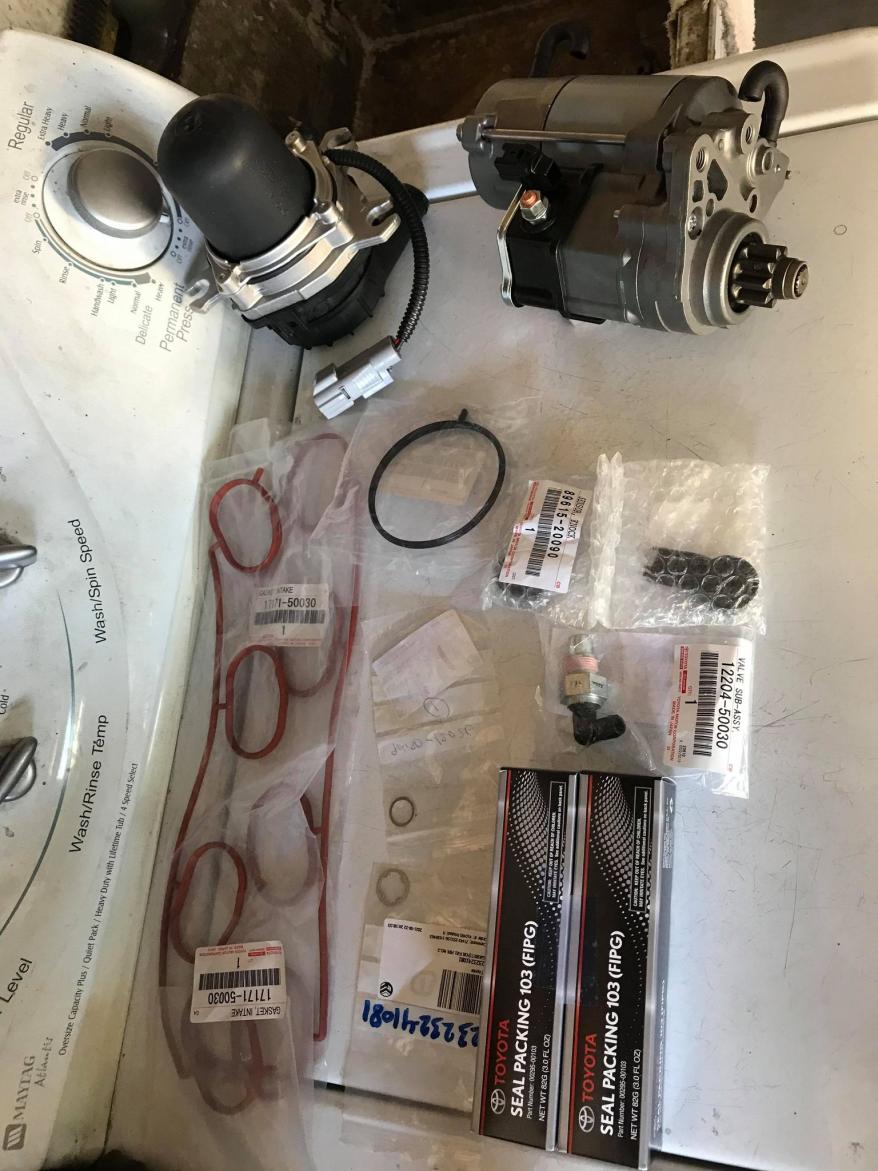

Here is the list of items I will be replacing:
Part Description then Toyota P/N
intake gasket (qty 2) 1717150030
air pump assy 176100C010
passenger valve cover gasket 1121350031
driver's valve cover 1121450011
QTY 2! Knock sensor 8961520090
PCV Valve 1220450030
FEL-PRO VS 50592 R Valve Cover Gasket Set (includes spark plug seals and valve cover bolt seals)
After printing out all the factory service manual pages I noticed you need to pop off the #2 fuel line and the FPD so that is why you see two odd gaskets for the fuel pulsation dampener.
I hope just draining the two top coolant petcocks on the sides of the block will be enough and that I don't need to drain the entire coolant system, we shall see.

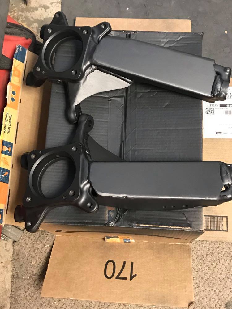

Knuckle Gussets

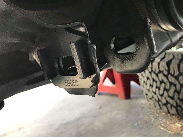

Cam tab Gussets
Top end parts for under intake weekend maintenance

My 4Runner is sitting in my garage with the intake off at the moment. I knew the starter was going to be tough but man! It's a real challenge. I've swapped 1997 FZJ80 labdcruiser motors faster than this!
The starter requires the water coolant bypass cast u piece above it to be removed (which requires two gaskets) in additoon to a water pipe that requires an o-ring, and EGR valve in the back gets removed! PAIN!
So I had to stop my wrenching sunday and order more parts.
These has to be ordered in addition to the above list:
water bypass gasket (qty 2) 16341-50020
EGR pass side vacuum hose 17340-50030
secondary air pump injection hose 17341-50180
hose off air switching valve 17342-50180
EGR pipe gasket (qty 2 +1 extra) 1737750010
replacement 3.5mm vacuum hose 90999-92003
water outlet pipe o-ring 96761-24019
Ø3.5 mm vacuum hose to swap old hoses under intake 90999-92003 (Qty 4 lengths)
