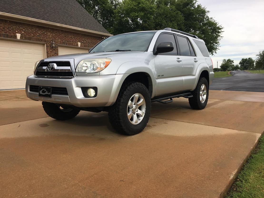

Im running my bilsteins at 2.5" with Fj coils so im pushing 4 inches. I just installed aftermarket SPC UCA's and it makes the ride feel like stock. I haven't had any problems so far.
