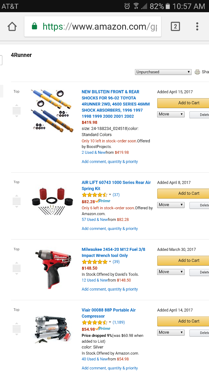

Air bags....problem solved....use when you want...have the nice comfortable ride when not. Plus for a 100 and an hours time.
Is this what you're talking about? It's already on my Amazon list for "4Runner". I read about it on another thread here. So should I even bother with springs then?
