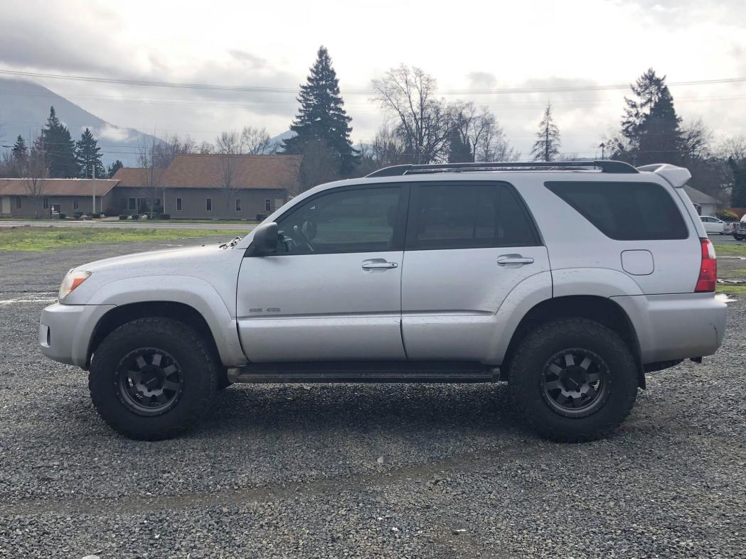

I'm running close to that setup. Bilstein 5100's all around, stock springs, 1.5" Daystar spacers in the back. The Bilsteins are set at the highest setting up front. Running 285/70/17 tires. Attached a photo of my setup.

Sweet! Thank you. Your rig looks great. I just ordered the toytec/eibach 2.5" springs for the front in a hope to save from being too stiff. How do you feel about yours on the 2.5 perch with stock springs as far as ride quality goes?

No worries, and thank you. I am quite impressed by the ride quality. I don't do anything that requires excessive amounts of flex/articulation while I'm out messing around in the woods, so I can't say how it performs in extreme conditions, but for every day use and BLM roads, the ride quality is top notch (pun intended). I may eventually purchase new springs, just because I've read that it's the way to go versus using spacers.
As a side note, I just aired my KO2's up from ~32PSI to 39 front 37 rear and she still has nice ride quality.

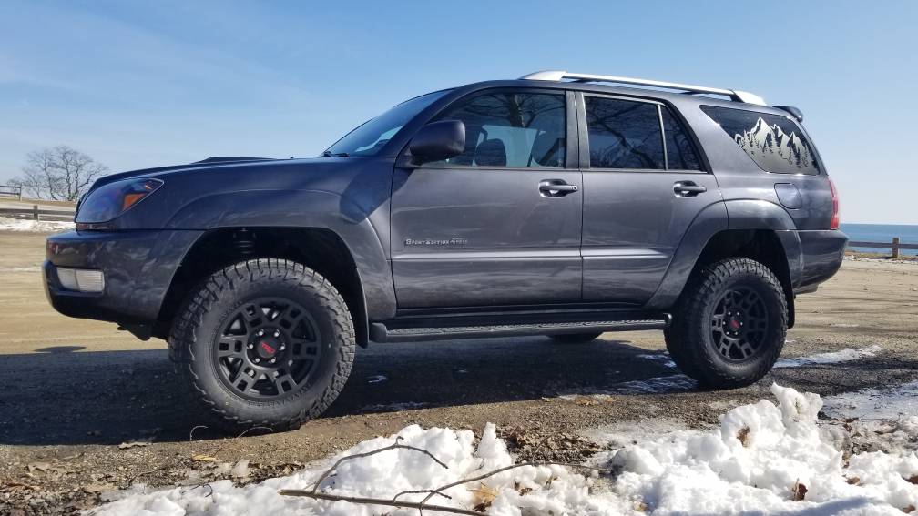

My Wildpeak265/70r17s rubbed on the mud flaps on sharp turns in parking lots.. Due to caster being off. UCAs would fix this. But I took the flaps off and it took care of the rubbing. May do uppers this spring.
I ended up with bilstein 5100s and toytec 2.5" springs up front... 2" daystar rear spacer.
Wildpeak at3w 265/70r17 on TRD 17x7 wheels. With even larger tires I'd expect some rubbing if you still have mud flaps. Easy enough to take em off though....
