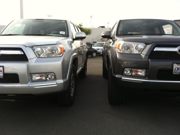

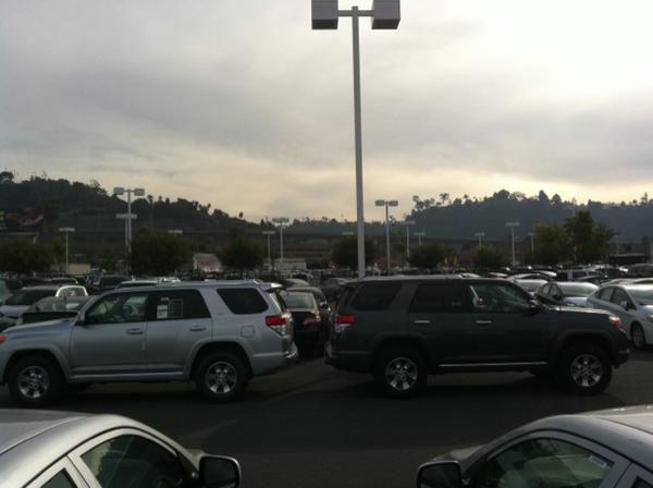

Just installed
Finally got my 5100s put in today (Set at 1.75").
Total cost out the door was $330 after tax, installation, alignment, etc...

Thanks man, the handling and especially the nose dive has been much improved... Amazing how much better these are than stock. I'm running stock tire size (265's) but AT tires so their a bit more aggresive looking. Not sure how 285's would fit, sorry.

Can't give you any feedback yet on towing, it may become nose high due to lifting the front 1.75" since it is almost perfectly level when not towing. I think it's maybe 1/4 an inch lower in the front now.

Mine didn't go up 2 inches... thinking about possibly choosing the 2.5" setting later on. 1.75" left it still about 1/4 an inch lower in the front (Was 2" lower when stock). Maybe 2.5" of lift in the front would still look good making it only 1/4 of an inch higher upfront, like the old 3rd gens look.
