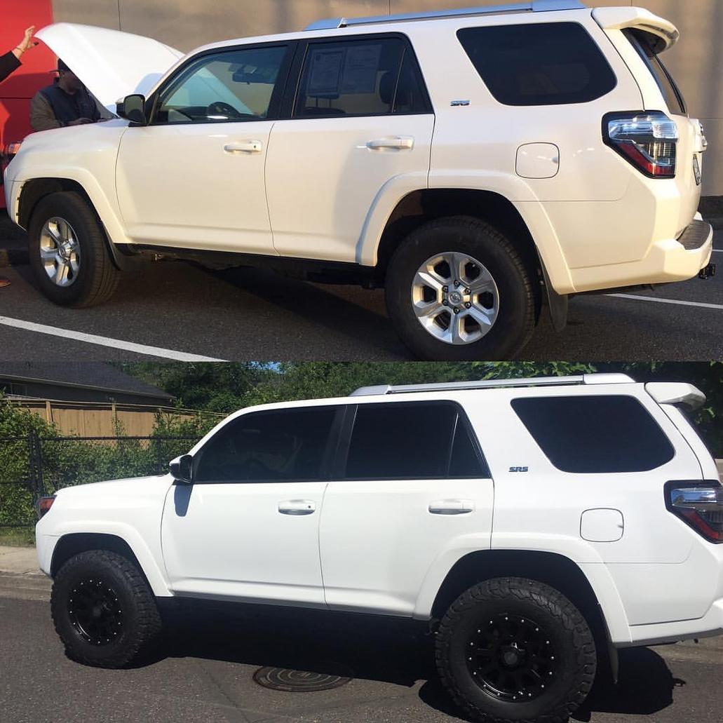

I started that way. Your body and fenders will sit level, but you will actually have a slight reverse rake in the frame. I thought it looked great but my off roading adventures got to needing a little more oomph, so I've moved on. Here is mine the day I had them installed at 1.75 front and 0 rear a couple years ago. This is with maybe 200 pounds of work gear in the back also. And bear in mind of you go this route you will need to adjust your headlights down.

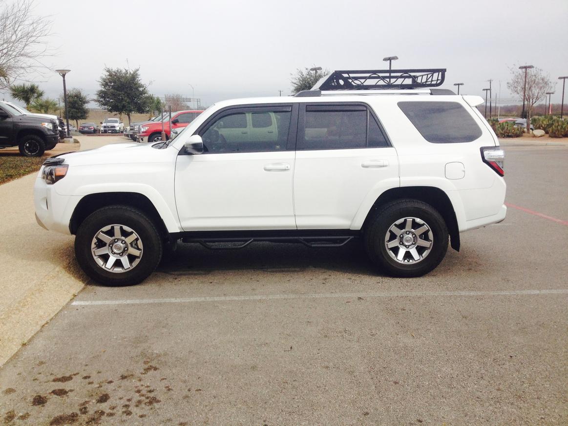

Just installed 5100's all the way around (3rd notch) with 1" cornfed spacers and 285/70/17 K02's. Had to trim the bumper a little and remove the mud flaps but I think it's looking good. There is also a -12 offset on the wheels. It's my wife's rig and she likes it so that's all that mattered I suppose.
