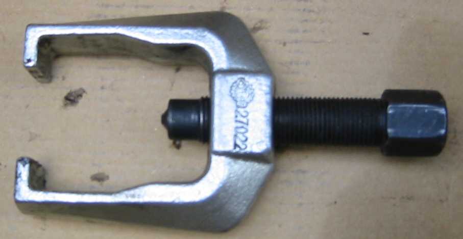

The ball joint stud is a tapered fit, and is pressed into the LCA. It won't come out with a hammer. The tool you need comes in a kit you can rent/borrow from your local autoparts store. Looks like this. Most kits come with a couple different sizes. You'll need the bigger one:
