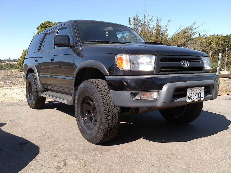

I had some Bilstein 5100's installed up front so my tires wouldn't rub. Got about 2 1/4 inches from the top setting on the shock.
They ride a lot better than I thought on the upper setting. It's not too stiff, yet there isn't too much roll in turns.

Looks pretty good man! Got any side profile shots???:artist:
I'll try to get a side shot tomorrow. After driving it around it's settled just a little and the drivers side is about 1/4 inch lower than the passenger side. I'm assuming this is fairly normal with older stock coils?

The rear end is stock and most likely going to stay that way. I've always liked the nose-high set ups.
I had a shop do it since I recently had surgery and won't be able to lift / spin wrenches for a while. I needed it done ASAP because my tires were rubbing and Off Road Warehouse gave me a fair deal on the shocks, install, and alignment.
If you have these shocks, I suggest the upper setting. The ride quality is pretty good, but may be slightly stiffer than your current setting.

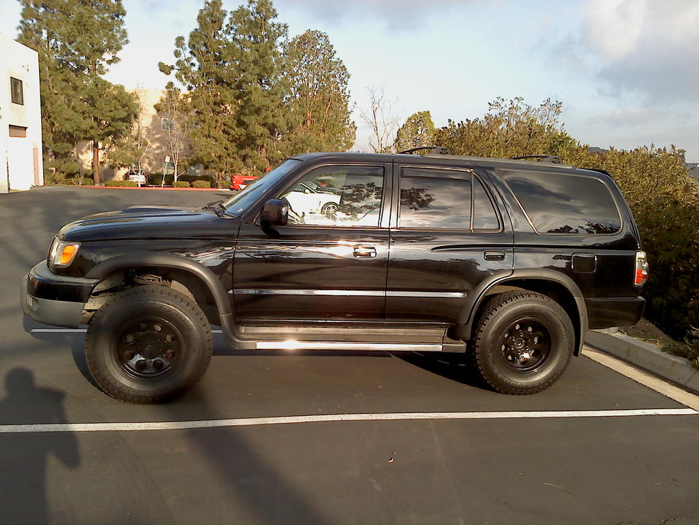

Cell phone pic from the side.
Does anyone know where I can get the stock front mud guards that line up with the flares? I want to take off the running boards, but I don't like the way the flares just end.

Good luck...and I think that rear needs to be lifted a tad. But looking sweet otherwise.

Dealer matched trdparts4u when I ordered mine. They're pricey but gotta do what you gotta do... and I 2nd the comment about the rear. Sagging too much but looks good besides that
