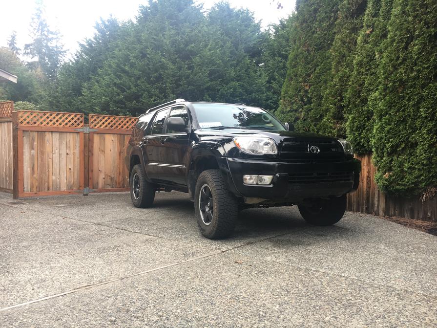

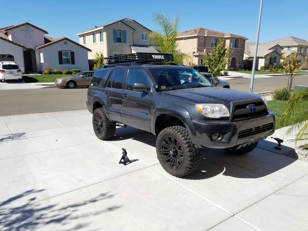

If you're gonna run OME springs, definitely get the OME shocks if you can.. They're valved to suit their springs better than the Bilsteins would be valved to fit the OME springs. I'm running OME 886's with 5100's 20160924_111352.jpg
Sent from my SM-G935V using Tapatalk
If you're gonna run OME springs, definitely get the OME shocks if you can.. They're valved to suit their springs better than the Bilsteins would be valved to fit the OME springs. I'm running OME 886's with 5100's View attachment 222193

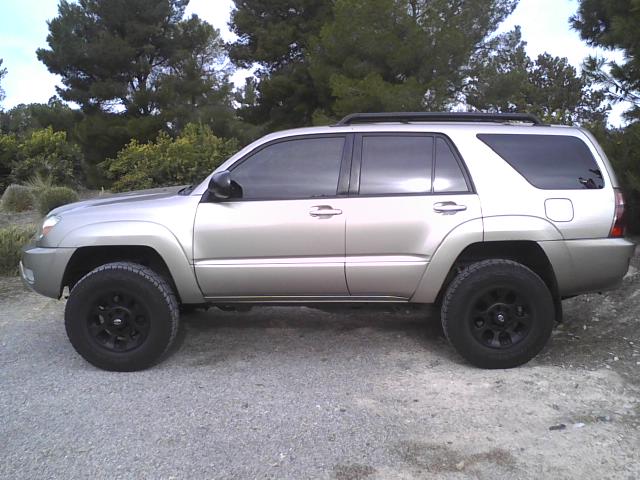

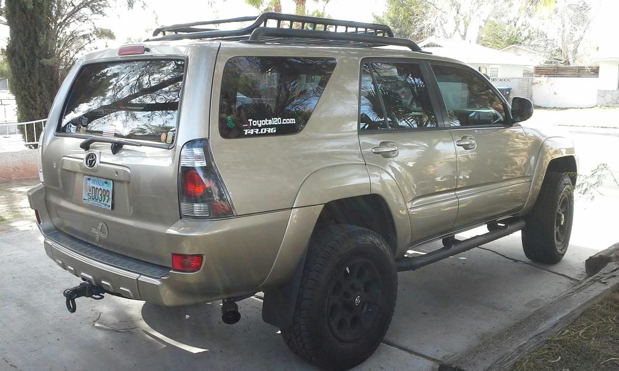

:flamethrwoer2: only v6 but son's 05 no spacer been a perfect ride 2.5 up front ,275/70s :):brick: it was mine before so I set it up for me but we both drive the sh*t out of it handles great & it doesn't have that top heavy feel when cornering very positive ! :violin:
