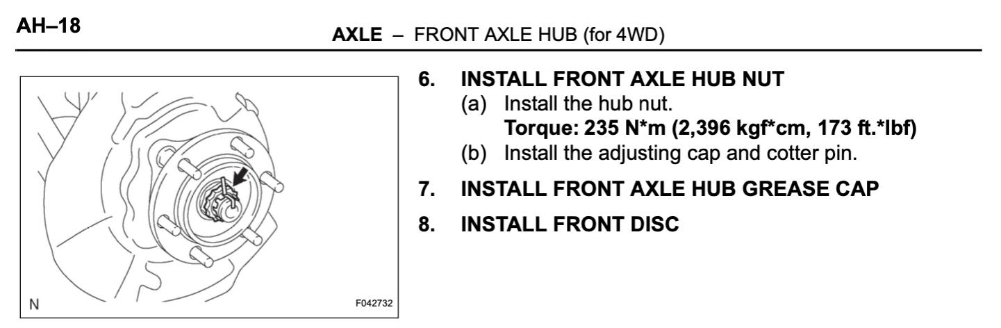

One other thing is at some point you want to loosen the outer axle nut. This thing is TIGHT like 250Ft lbs or something like that. The way I do it is jack up, take wheel off, take metal cover off, put wheel back on, lower down then un-torque axle nut, jack back up, take wheel off again. Now you are ready to remove the spindle and then the axle. Good times! Of course going back on is just as much fun. Assemble everything but leave the metal nut/bearing cover off, install wheel, lower back down, torque nut, jack back up, remove wheel, install locking devices and cotter pin, install metal cover, install wheel, hit the trail for some "hard line" wheelin' Good Times!
I had to look up the toque because...

Yes front diff output seals would be a good item to change just because. There are outer dust seals at the axle end that meets the spindle bearing (wheel bearing) I ripped one of these and had to wait for another to be delivered the next day so....Also be carefull once you have your new axle installed and before you re-attach the spindle. Set the new axle on some rags or similar while it rests on the lower control arm. You could actually cut the new outer boot if you are not careful.
