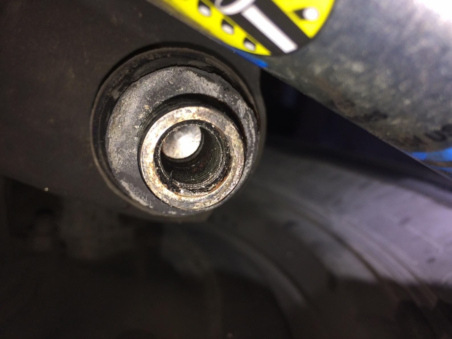

Hello All,
Looking for the size of the rear bolt for the lower shock. Came home to a nice rubber smell. Rear 5100 lower bolt completely missing. Looking to replace & fix. Found part # 90119-A0018 but its for a 5th gen. Looking to see if I can pick up at local parts or hardware store. Thanks for the help!

rear lower shock "bolt w/ washer" 91619-G1222 torque spec. 47lbs (not 74lbs) cost was arount $2
m12, 20mm length,1.0 thread pitch (if you find one at store).
OEM is not grade 8+, I've stripped one at 74lbs. and now keep an extra on hand.
