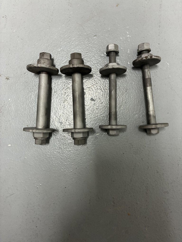

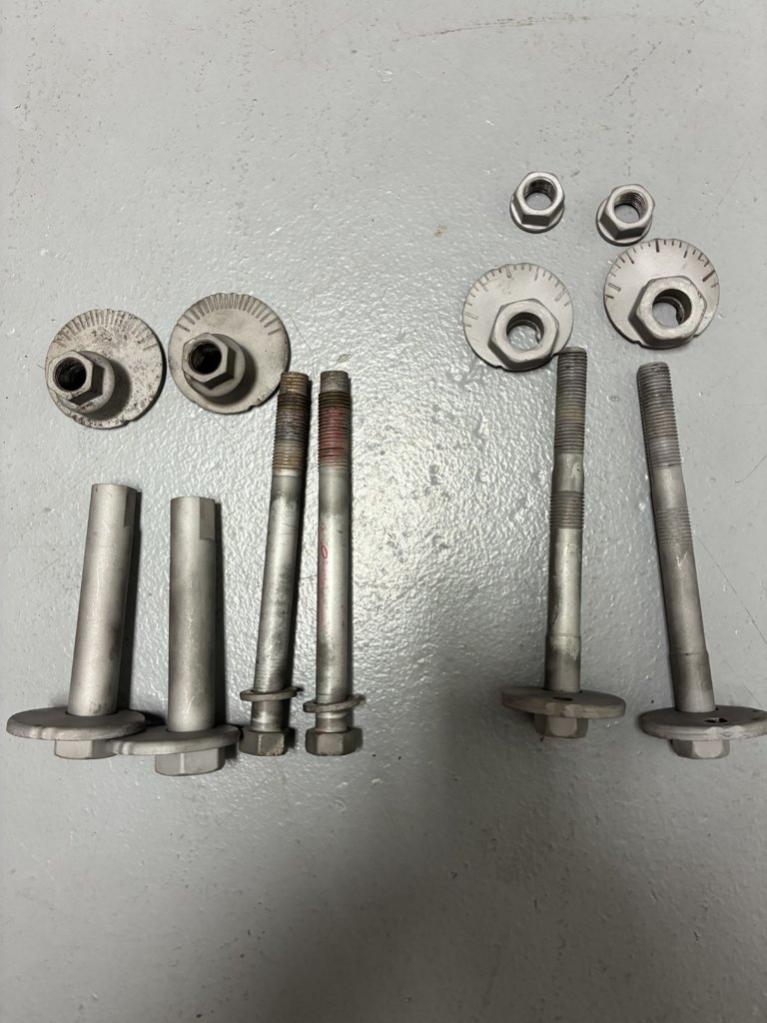

That picture may have been kind of a generic picture. I posted that up just kind of for reference.
Each bolt basically consists of 3 parts, the Camber and the Toe. The large barrels/Ferrules on the left are what like to get seized inside the bushing.
My bolts could still be aligned and moved, but when pulling my old LCA off, one the the ferrules was seized inside. The rest of the bolts were really rusted bad.
