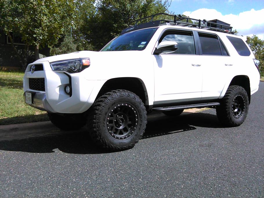

here is toytec 521600 front springs (2.5") on the SECOND notch of bilsteins 5100. so between 3"-3.5" of lift up front. the ride is very nice. have all pro 3.5" rear springs and pro comps schocks on back.
That's one sick looking 5th Gen! I love the new bumper they put on the front of those. Will make it hard for aftermarket steel I'm sure, but they look so aggressive I really love them. :guitar2:
