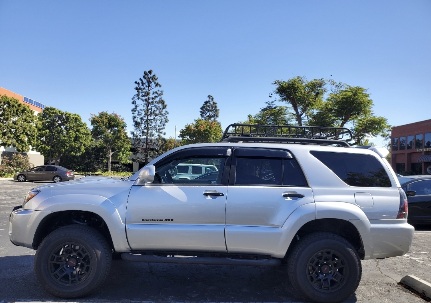

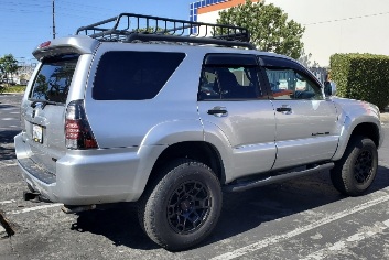

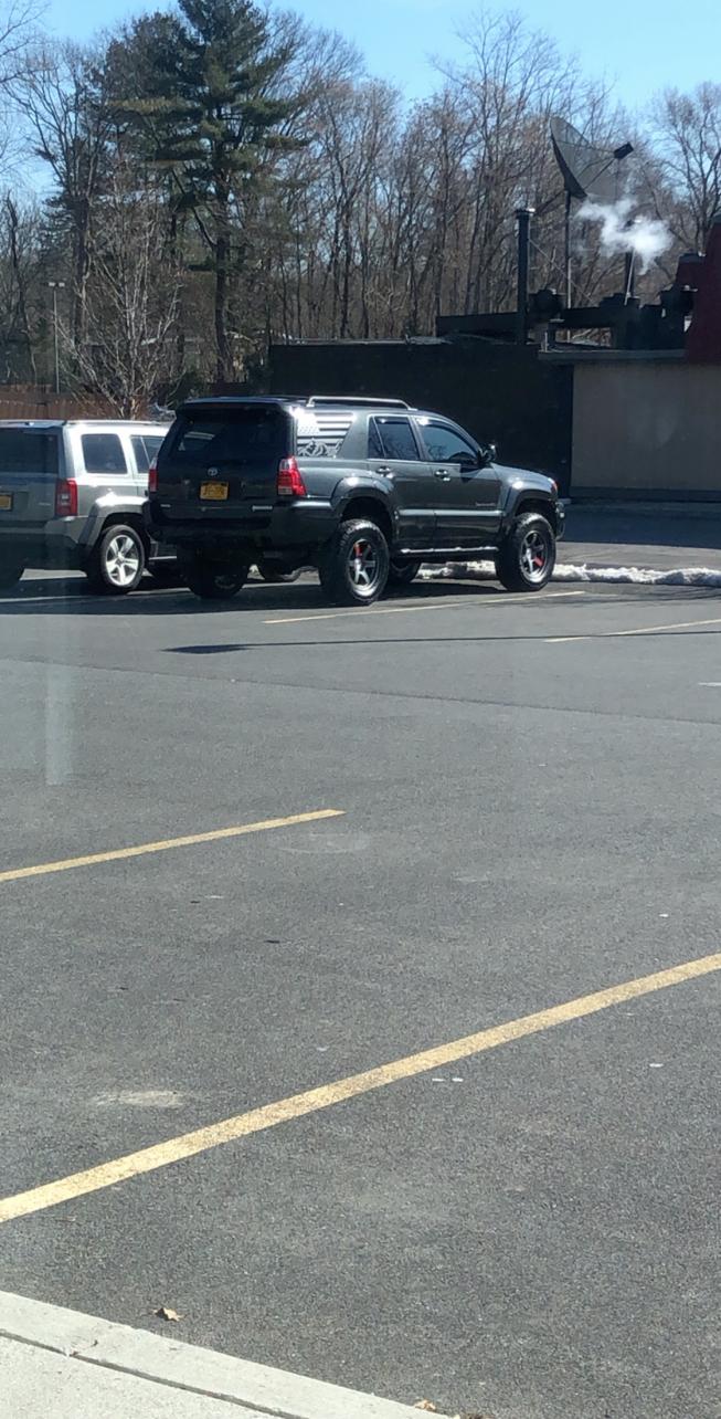

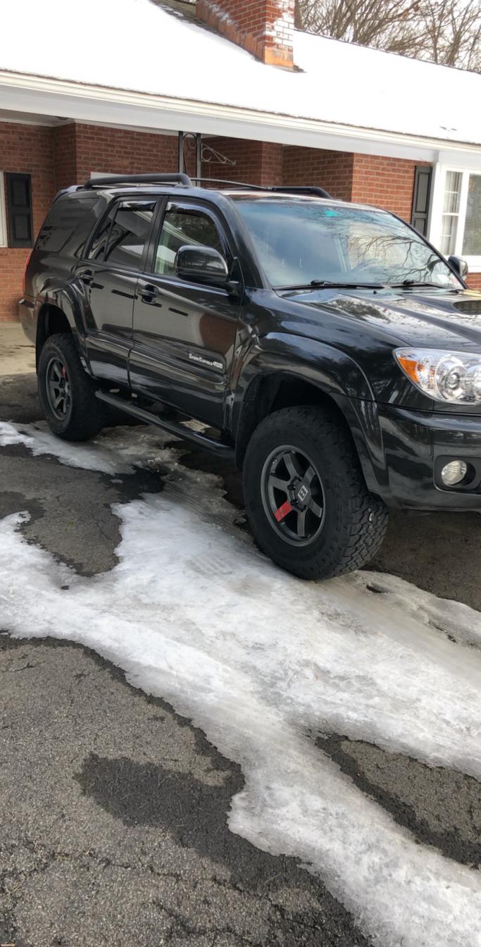

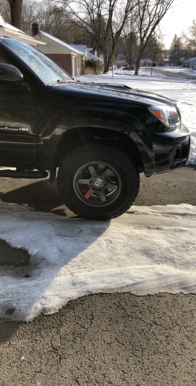

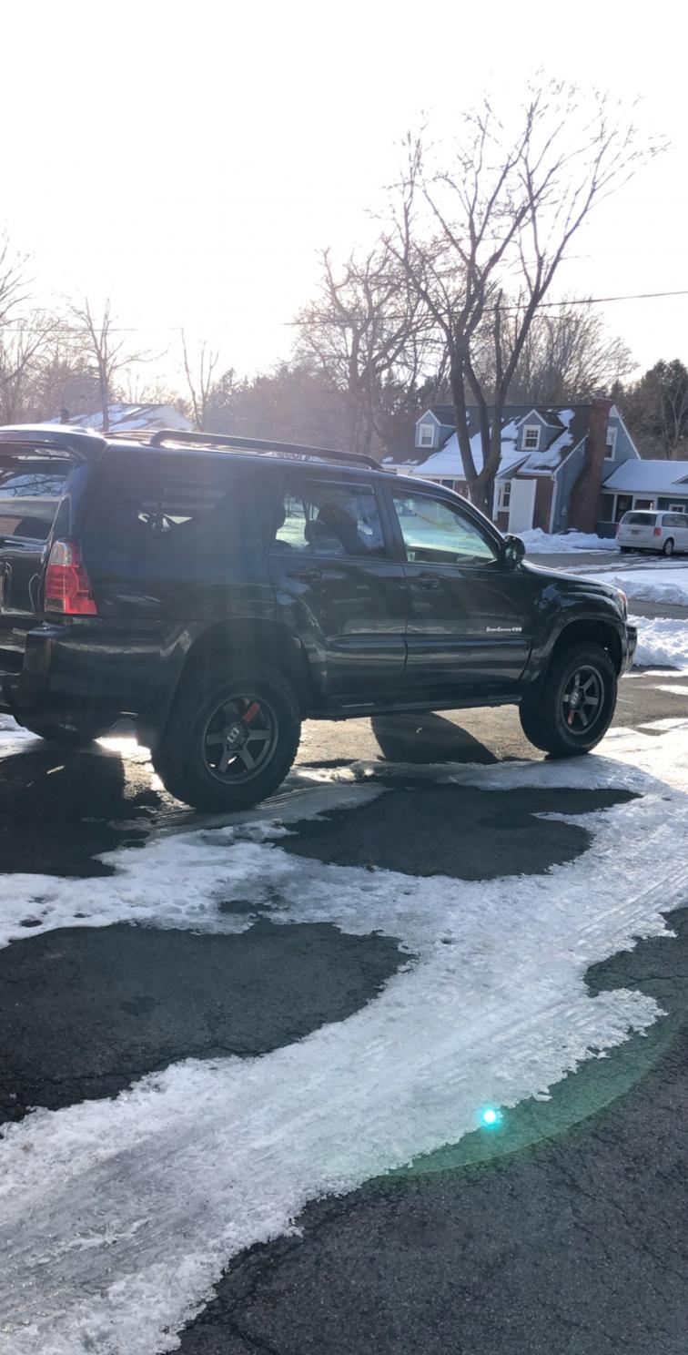

Got any pictures of your truck with the T1 and 12s installed?
sure, i have them posted somewhere else on here too.
I was going back and forth for a week if I wanted to set front shocks to .85 or not and I didn't. I bet it would look fine if you did, but im happy with where it is at.

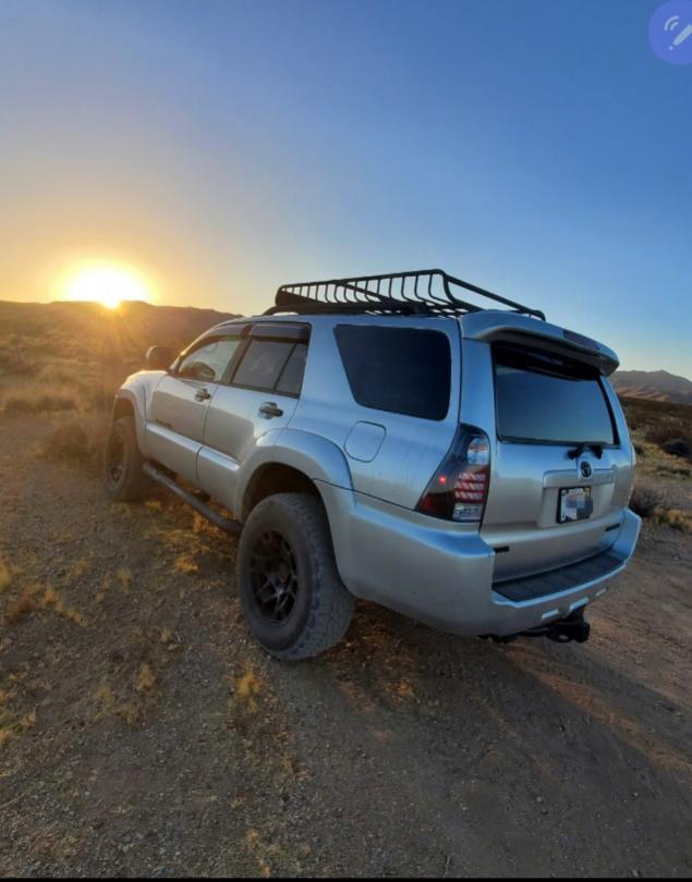

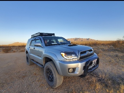

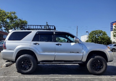

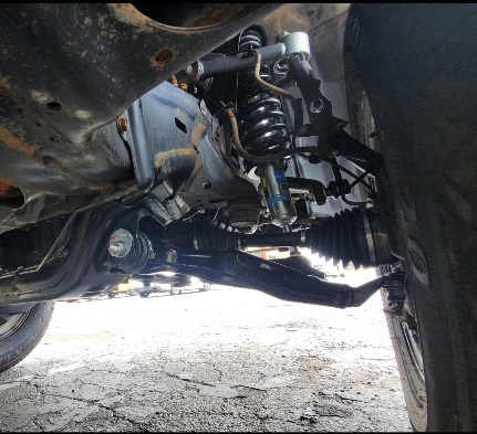

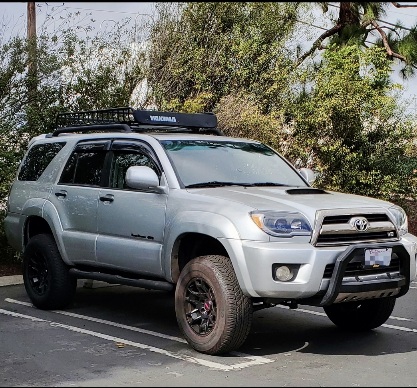

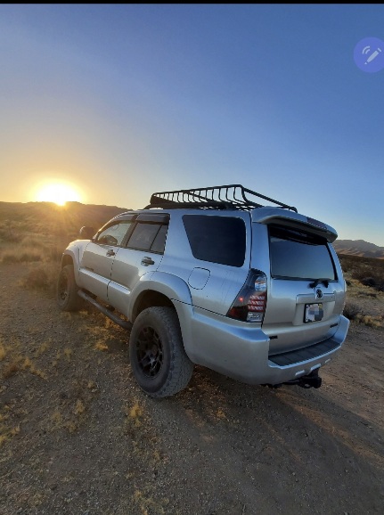

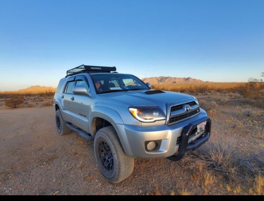

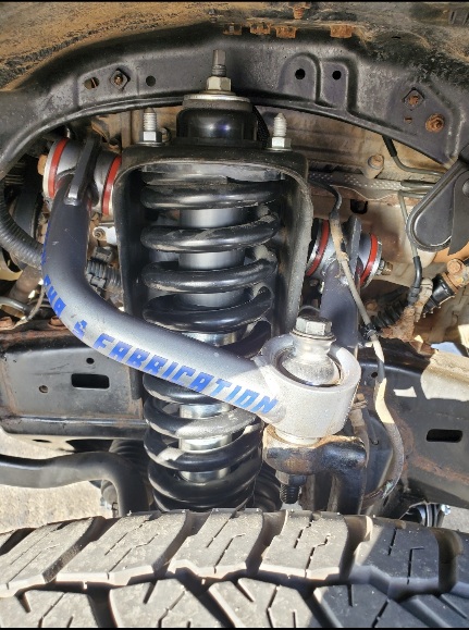

About 1 month with new 5100 885 one fronts and 2895 rears ome rear springs with new koyo bearings/hubs, new xj axles with oem boots, total chaos upper arms and moog lower also ininstalled 5th gen calipers off 2014 T4R WITH NEW OEM Rotors/pads. Really like the way it sits abd rides. But I think I will bec upgrading the shocks in next once my money recovers a lil lol

I just bought this beast..BTW. this was the ONLY 2009 v8 4wd sport edition For sale in Cali! Possibly in the nation.. these the trail and urban runners are now unicorns. Extremely hard to find.
