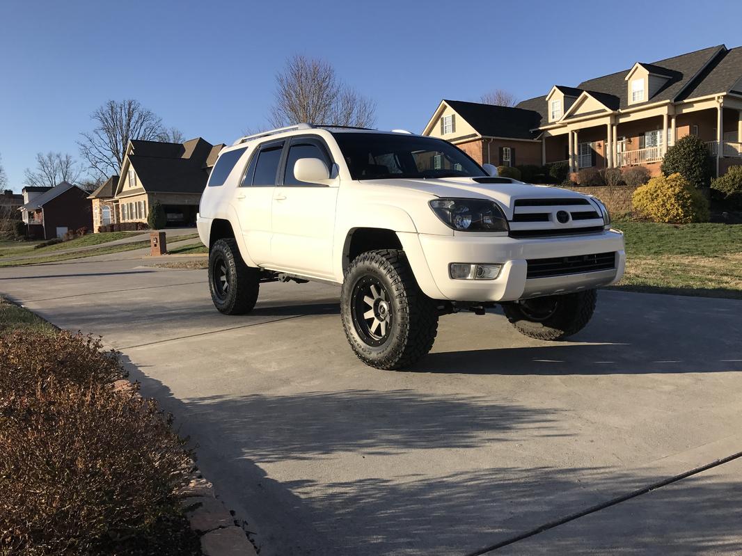

Just FYI, my rear set up is Toytech superflex 2" rear spring with a Daystar 1.5" spacer cut down to 1" on both sides. I am setting exactly 1" higher in rear that the front. All the way around.

You're absolutely right. The actual height varies from vehicle to vehicle. Because I couldn't find the proper answer to my question, I had to use my truck to RnD. Now that I know what i need to do to get the same height i can move into a properly set up coilover. I honestly don't see 5100's holding to 33's, much less 35's. I do however, like the digressive set up on the 5100. I think Icons will be the choice of coilovers.
