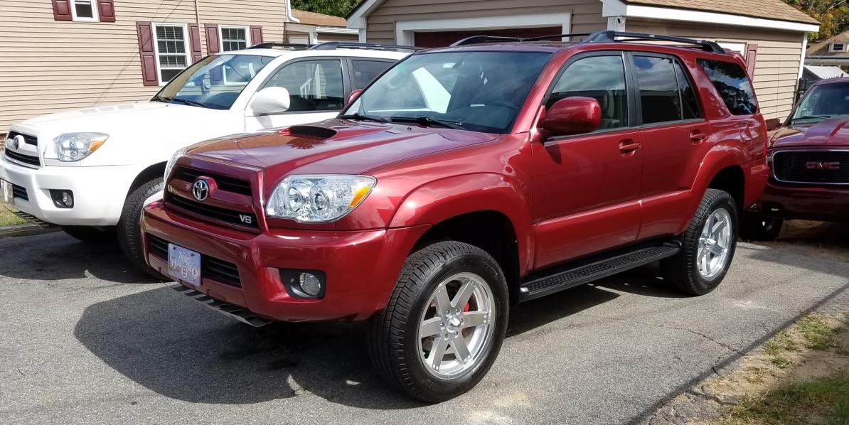

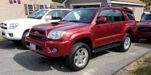

Hi all. I am replacing the xreas in my 08 4runner. I currently have the 6112 and 5160s in my 06 and i like the ride, handling etc.. with it. I was just wondering if its overkill for both being non off road vehicles. Would the 5100s with t1 and t12s be a better choice for the 08? Obviously the 5100s are much cheaper even with the springs. Is there that much of a difference? I just dont want to put the 5100s in and not be happy with the outcome.
and i like them b/c with the staggered c-clip settings the lean is practically eliminated and i like that the B12 coils are paired damping wise with the. I have mine set @ 2.13"
I Have the 650lbs springs on my 06 with the 6112s and the ride is really good. I also have the v8 in the 06.
What setting do you have your coils at and how much lift are you running. My goal is around 2.5" before I add the bumper.

I dont remember what setting I have but i did the 2.5 lift as i have a set of wheelers off road t12s in the back. I went one setting down due to the v8s weight compared to the recommended setting from bilstein.

That should get me close enough. Thanks man. I just don't want to preload the smoothness out of the ride. The roads out here suck in michigan.....I don't need them to suck any more because I have too much preload.
