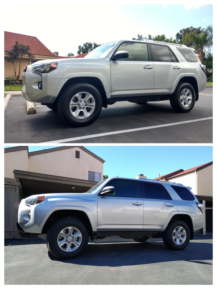

5100 installed
I just installed my 5100's. Set the front to 1.75 and I think it looks great that way. I hear the reader shocks settle some so my nose might be a little higher than the rear :(. Hopefully it's not a huge difference.
The top photo was before and bottom is after.
