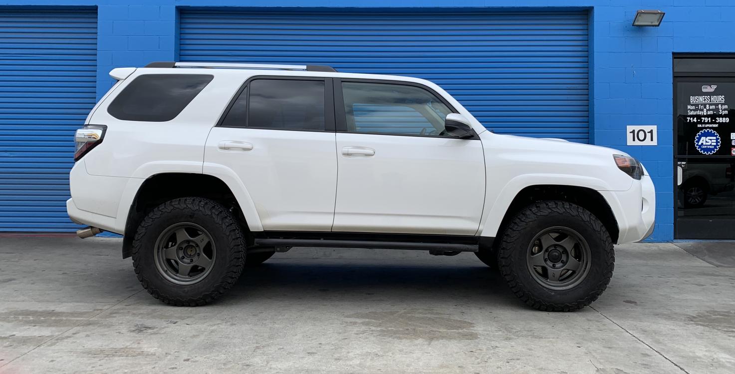

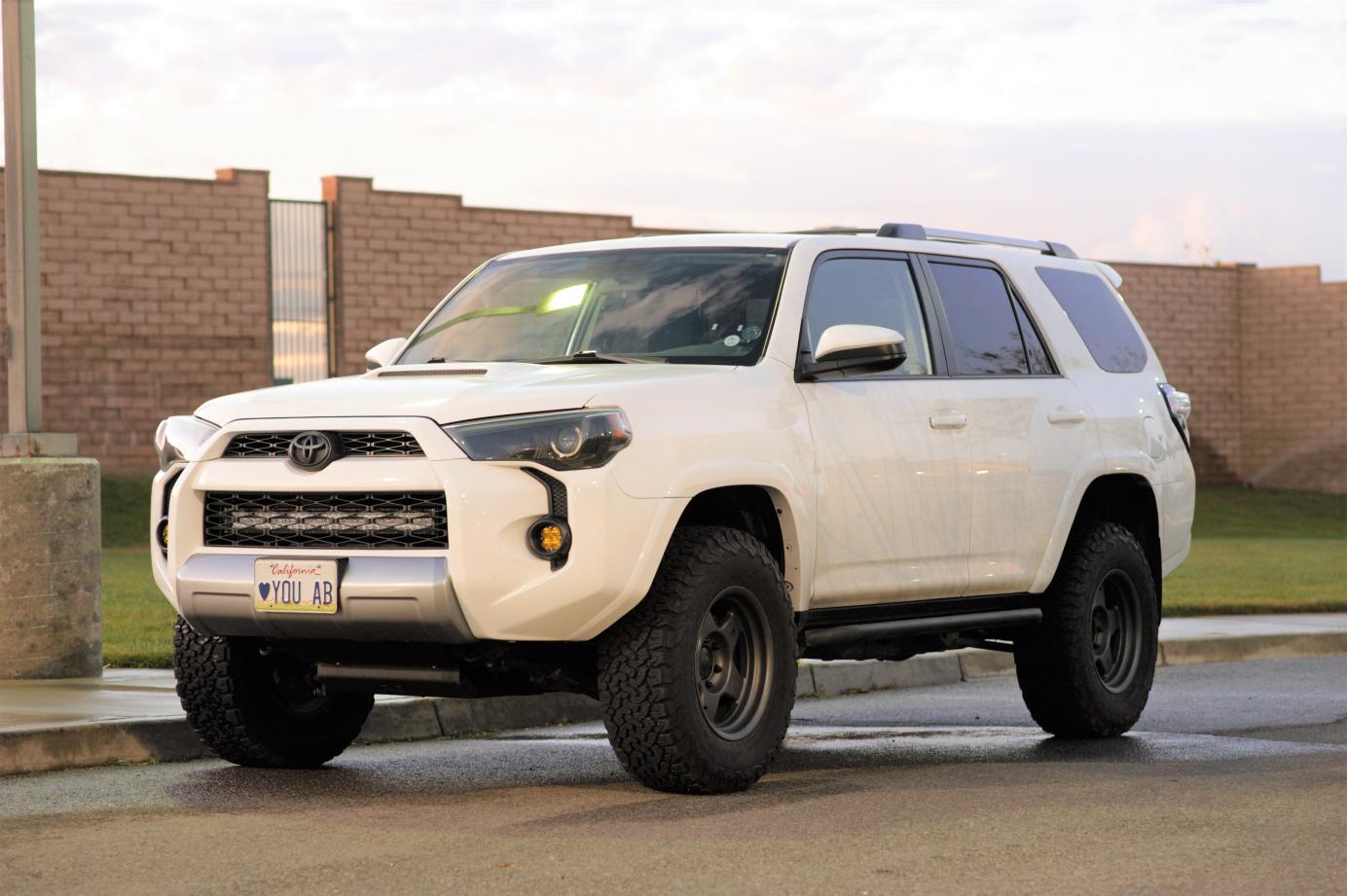

I have 5100’s with the Wheeler’s T1 and T12 setup to maintain the factory rake. The T13 should give a bit more of a leveled look. I previously had the Bilstein’s set to 1.75 lift up front on stock coils along with 1” rear coils and the ride got pretty rough. There’s a noticeably smoother ride on road with the Wheeler’s coils and Bilsteins set to 0. I think it’s a great set up, especially for the cost. Good luck!

T13's will get you at most 1.25, if you use 10mm trim packers/spacers.
I wouldn't buy them again.
Are you saying they are more like an 1”? My other option was to do the Eibach Pro Kit and just add a Cornfed .5” or .75” spacer.

My only regret is not going this route in the first place so I would’ve saved some money by not having to purchase the original 1” rear springs. Oh, and I definitely recommend getting some aftermarket UCA’s. I know they’re not needed for 2.5” lifts, but I wanted to be sure I could get back to factory alignment specifications to help the tires out.
