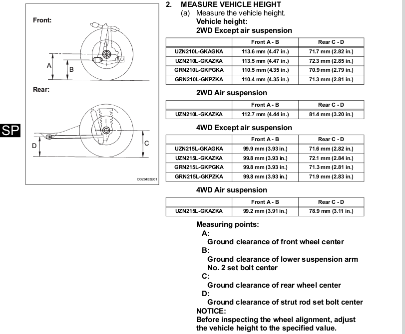

You can use this information from the FSM to see if your vehicle is still meeting stock ride height specs. If it is, your old springs are fine. If it's sagged more than a small amount, you might want to change them.
  • Screenshot from 2016-08-21 21:37:07.png
